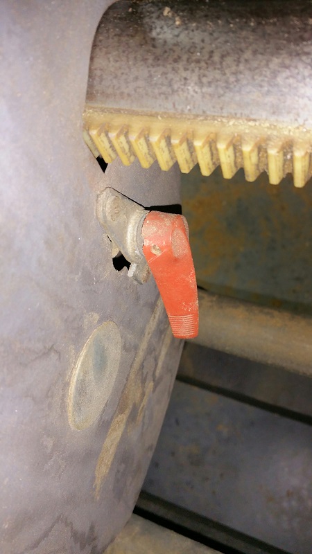

Also, what does this little red nob do? I see that it turns a little cam on the inside of the belt cover, but not sure of the function of that cam. Does it lock the headstock down? it seems a little small for that.

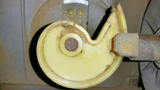

Better image of the notch in the control cam.
2015-10-07 08.03.01_resized.jpg (43.32 KiB) Viewed 1672 times

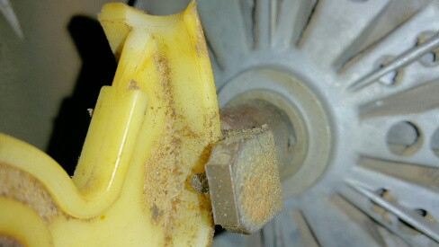

cleaned up control cam image. I guessing that the top isn't supposed to be "notched like that. I'll upload another file
2015-10-07 08.01.57_resized.jpg (58.21 KiB) Viewed 1672 times

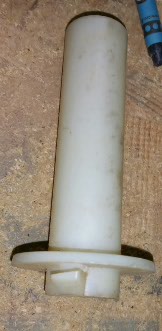

What is this?  Came in the box of parts, but I'm not seeing where it fits.  Is this a vaccum part?
2015-10-06 22.19.25.jpg (15.2 KiB) Viewed 1720 times

no clue.
Maybe, could judge better if it was visible(clean that crud off ;) ).

The little red knob engages/disengages the spur gear to the track to allow sliding the headstock without 'cranking'.
Notch on cam caused by ??? Possibly due to revolving too far towards fast and rubbing the control sheave hub.

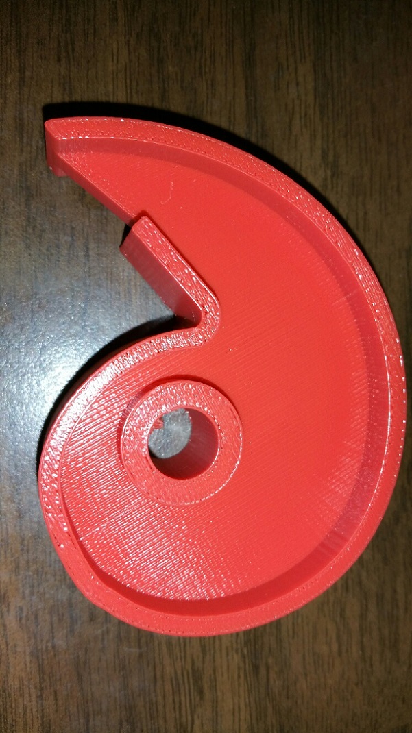

Spare 'red' cam. Lucky you. Source?????

Other than the notch, the cam also looks very good.

red cam was printed on my 3d Printer with high impact ABS.
Once I have the design tweaked, I'll make the files available for any that want em... Unless, of course, that would be a violation of the board's rules.

I do not see how our sponsor would have reason to object to someone creating a solution to parts no longer available from them.

I have to tweek my design slightly, but it looks like a viable part.
