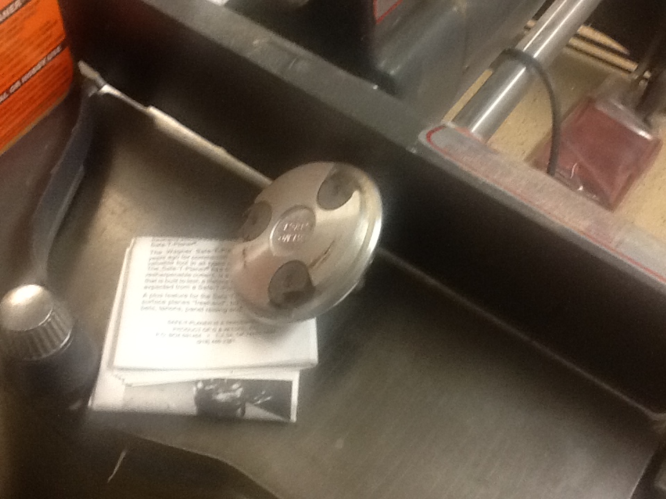

You mean one of these? I purchased this on eBay when it was announced that Wagner was stopping production. I needed it for a banjo project I've yet to start (3 years now!) if anyone needs the printed directions, drop me a line.
- image.jpeg (181.39 KiB) Viewed 7161 times
- image.jpeg (205.46 KiB) Viewed 7161 times

That's the one! I'm going to have to pick one up. Too interesting to pass up.
