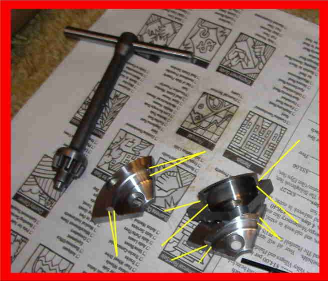

Hi,
My new shopsmith toy arrived, the Nova G3 lathe chuck. While I've done a lot of things with my shopsmith this is the first time I have gotten a lathe chuck so maybe some one can tell me if the edges as shown in the photo should be smooth or not. On mine there is a burr left behind from the machining and either it should be there or maybe was it just not finished very well?
One of the 4 jaws one is smooth the remaining 3 have the burrs and it ranges from a minor edge you can just feel to two that are quite large... they were snagging the fabric of the rag I was using to clean the oil off.
Gut feeling says they shouldn't be there but what do I know about lathe chucks????
[ATTACH]17[/ATTACH]
[ATTACH]17[/ATTACH]
- g3 jaw set.jpg (36.8 KiB) Viewed 33781 times

That's a real shame. Nova's stuff has ALWAYS impressed me. It's always been top shelf. Sad to hear that they let this one out the door.reible wrote:So far I am far from impressed.
No, the burrs on the jaws should not be there, absolutely not. Anything burr-like runs the risk of making a mess of the project you're trying to create and protect.

I went to the shop and got my hood on which improves my vision about 2X and looked at the chuck parts again. It looks very much like the parts were cut in to the pie shaped pieces and then nothing more was done to get rid them of the burrs left by this operation.
I spent about an hour with a set of die files and cleaned up the burrs and wire edges left from their cutting operation. I then used a power wire brush to get anything I might have missed. I was going to do a bit of polishing but in my fall clean up I misplaced my sticks.......
They feel and look much better and I went ahead and mounted them on the chuck. Everything seems to fit fine.
