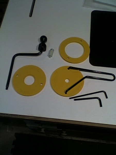

Standard and optional parts.
The lift comes with three inserts, 1/2”, 1-3/8”, and 2-1/2”. The actual hole in the plate is 3-5/8”. It also comes with a nice little wrench that locks and unlocks and lifts out the inserts. It works well, making the changes fairly easy. In addition to the inserts, it comes with a pin (screw with plastic sleeve), so that it can be used in free hand routing. It also comes with two allan wrenches, one to tighten the router in the lift, and another (ShopSmith size!) for the corner levels. (Picture attached.)
An optional five piece ring set is available for $25, but I haven’t got them yet. The optional set has a blank plate so that you can drill it for a special bit, 3/4”, 1”, 1-1/2”, and 2”. As you can see, the optional set is something I want to get soon, probably by missing a few meals over the next month.
Other options include reducing adapters for different routers, as the lift was designed around the Porter-Cable 7518/7519. Since I am using the Makita 1101, I needed the adapter for it. The adapters are $30. Jointech also sells a routing template for the 9-1/4 x11-3/4 plate. That sells for $16. That finishes what comes as standard and also the options available.

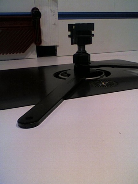

The raising machinery is well protected from dust, and also from accidental change. To change the height, you need to first push down on the crank handle. This prevents any accidental change of height by catching the wheel that is on the surface of the plate. That wheel is a little recessed, as is the digital readout. And the digital readout takes out any “slop” from changing direction. After raising, I started lowering. There was a quarter turn on the crank handle before there was any change registered on the digital readout. So the mechanical “slop” is still there, but the digital readout is not affected by it. The digital setup is by Wixey, for those of you that know the name. Another good point is that the digital display turns off automatically after 15 minutes. It will also turn on automatically if you start to change the height. So there is no “I gotta remember to turn this thing on/off for it to work/not let the battery die.”
The threading on the lift is 1 in 16, so that it takes sixteen turns to raise the router one inch, and a 4-1/2 inch range. That is a lot of cranking, but I figure that most bit changes won’t come anyplace near to using the whole range. The plate has snuggers, so that the router plate hole can be slightly larger than the plate, so that swelling won’t make the plate impossible to get out. The corners also have leveling pads, so that the top of the plate can be level with the top of the table. The downside of the snuggers and levelers is that they have to be accessed from beneath the table. For most normal tables, this isn’t a problem. In and enclosed system like the NYW, it can be a little tight. Being lazy, I draped did this on the sawhorses that I built the top on. But, to be honest, using the longer SS allan wrench, it wouldn’t have been much harder inside the router station.

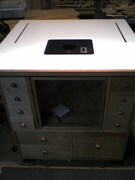

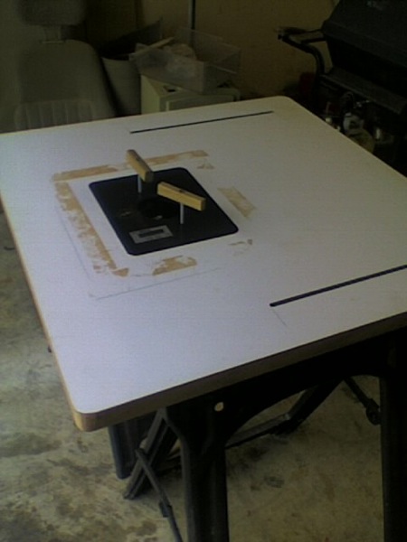

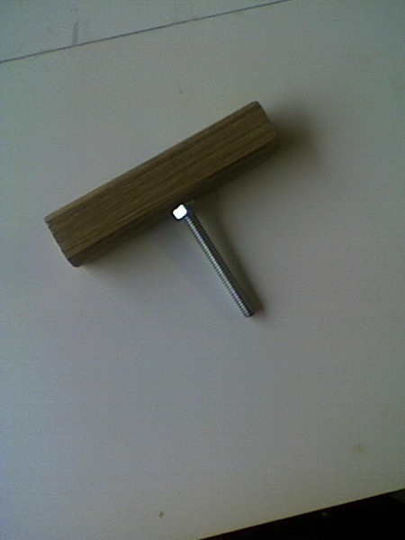

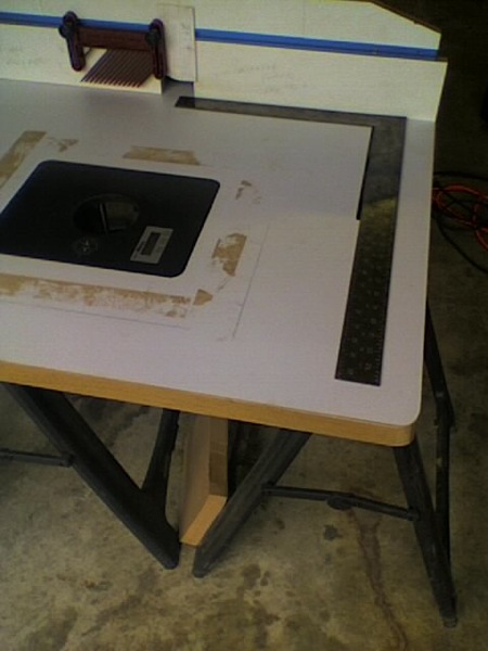

The owners manual said to make sure that the router was in the lift when the leveling and snugging was done, as the weight of the router could affect the results. With my expanded table, (1.5” x 37” w x 34”d (see picture attached) this makes of a heavy setup, unlikely to be moved or shifted easily. Removing the lift, I put the top on the router station, then put in the lift. Being anal, I again checked the plate to top level again, then proceeded to set up for an actual test.
The first test is getting a bit in, lowering it to zero the bit, then raising it to cutting height. Cranking it up to change the bit was slow, but this is a new toy, so what the heck, right? You could also pull the lift out and do it that way, but be aware that the Wixey “measuring stick” that is used to tell the distance moved can extend below the bottom of the lift. If you set the lift down on that “stick”, you could bend or distort it. I have two handles that I use to lift out the plate and router. Simple hex bolts through 3/4” x 1/2” x 5” pieces of oak, with a recess for the head. (Picture attached.) But his is more of a pain than the cranking.

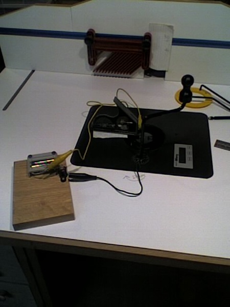

To zero the bit with the plate, I stole an idea posted on the JoinTech Forum. Using two 1.5 volt batteries, a flashlight bulb (he used a buzzer, but I had the bulb setup from another project), and some alligator clips, I set up the following: Alligator clip wire attached to the bit through the plate opening. Other end attached to the battery, which is attached to the light. A second alligator clip wire is attached to the other pole of the light (or buzzer). The other end of the second wire is attached to a piece of metal (I used the handle of a combination square) which is laid across the opening (insulated by a sheet of paper from the metal plate.) With the square directly above the highest cutting point of the router bit, raise the lift until the light goes on. Unclip one of the wires, zero the scale, and remove the whole contraption. All done above the table, quickly, and repeatable every time.
One caveat: make sure that the bit you are zeroing has any paint, grime, etc. removed for the area where you want to make contact. A good hint that there is a problem is the combination square lifting with no light going off!!! As an aside, this can be used with a metal router height scale for non-digital router setups, saw height, whatever. Feel free to steal and adapt this idea. (I did.) I will post a separate thread on how I built this zeroing setup, so that anyone interested can build one.
The bit I used was a glue bit, to be used in joining boards for cabinet sides. Since the middle of the glue bit is supposed to hit the middle of the board (feel free to correct me if I’m wrong), I went anal AND lazy AND cheap. Using a fine point pen that fit snugly inside a doweling jig I have lying around (pictured), I tightened the jig to the just snug position on the board. Then with the pen in the jig held with a thumb, I slid the jig a couple of inches. This left a line in the center of the board’s edge. I then raised the glue bit so that the center of the bit was on the line. Using test boards, I checked that the setup was correct. So I had that as a starting point, saving me time and frustration, to say nothing of wood. (The next purchase will be a digital caliper so I can find the center of the bit and reduce frustration even more.)

Next step: Write down the digital number shown on the display!! At the least, somewhere on that nice new countertop, better in a little notebook that goes in one of the drawers, or best yet, on the router bit itself, as one recommendation had it. (That last is a good idea, but I haven’t found a pen yet that wouldn’t wipe off the shaft. The recommendation said on the end of the shaft, but I haven’t found a pen (or eyes) that could do that. I’ll have to test a Sharpie on the body and see how it holds up. So far the notebook idea is the best I have come up with.) And keep in mind, this measurement now works regardless of the router used. It is only bit dependent.
At this point, a proper test would raise the bit, take it out completely, reinsert it, lower it, re-zero it, raise it to the aforementioned digital number, cut a piece, and compare it to how the other two pieces fit together. So that’s what I did. And frankly, I couldn’t tell the difference in the fits. And that repeatability it what I got this lift for.
On the watch out for it side. Turn on the router for a couple of seconds before settling on the height. Sometimes the vibration will change the reading by .002 or .003. Not a big deal, and running longer won’t change it any more.
Also, when I rezeroed, I didn’t use the paper to insulate from the metal router plate - it wasn’t necessary. But tests always help.
Another thing I found out about this test. This much larger table top is handy for more than just layouts. I was able to use the space behind the fence for the pieces waiting to be cut, measuring tools, pencils and pens, and the piece just cut. So as far as I am concerned, that idea has already paid off, even though I haven’t built the Incra Jig fence yet.
