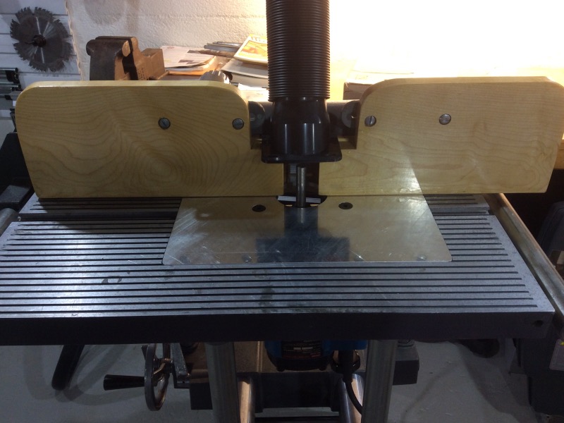

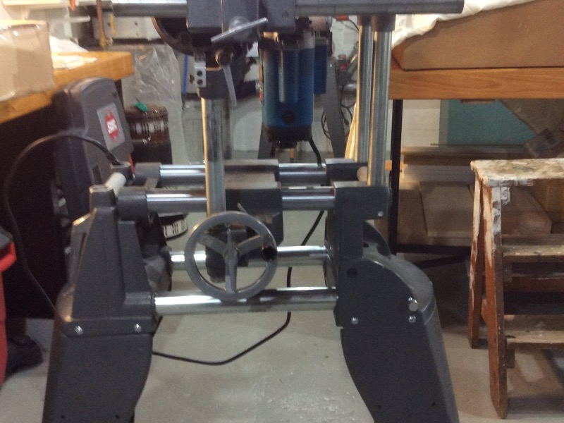

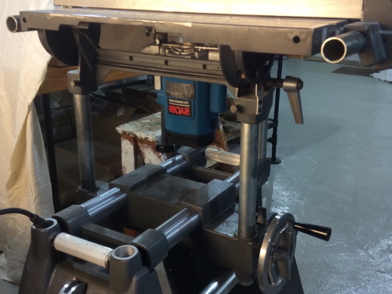

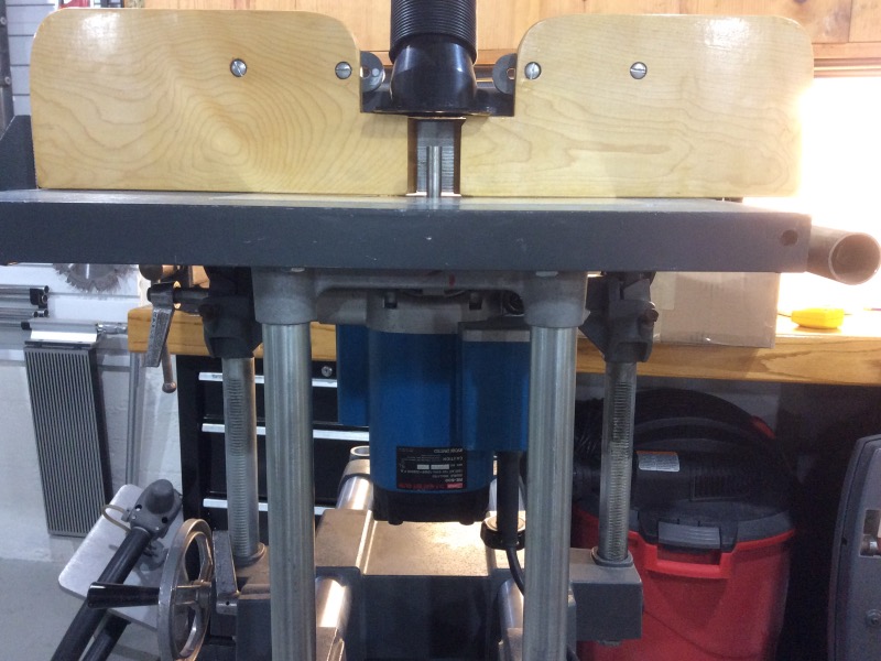

Here is my attempt
Post by cooch366 »
It's not a 500, but you get the idea.
I picked up a used 510 cheap, and cut 18" tubes, removed the headstock and used a shorty as a router station. I also use the other end to store my band saw when not in use. Plus I now have a spare headstock.

Exactly what I was thinking. It looks like you attached router to plate and then have the plate sit in the table? how did you cut the table? How is insert sitting in table top?
My extra 500 table has a round hole for disc sander and I was think of just attaching to table and use the hole instead of the insert you have. Cutting table seems like a daunting task.
Great job by they way.

tdorey wrote:Exactly what I was thinking. It looks like you attached router to plate and then have the plate sit in the table? how did you cut the table? How is insert sitting in table top?
Thanks, I used 1/4" aluminum plate and had a local machine shop mill out what I needed to fit it in. Not really a big deal. In milling it there is enough support in the table to support the plate and the router. I then drilled the plate to match the screw holes in router and countersunk the plate to fit flush. A couple of things to keep in mind that I found:
I centered the bit so that I could use a shaper fence ( be it modified with the wood blocks and fences.
Beware that on the 500 table you have the cross member / support to factor in, your router will need to clear it on the underneath.
My original plan was to mill / fabricate the plate the same size as most standard router lifts. That way in the future if I wanted to add it I could remove the plate attach the router and insert the lift. Unfortunately in my case I had a mis communication with the machine shop and it is not the size I wanted by it still functions as I wanted, I just don't have the ability to add a lift in the same space.
