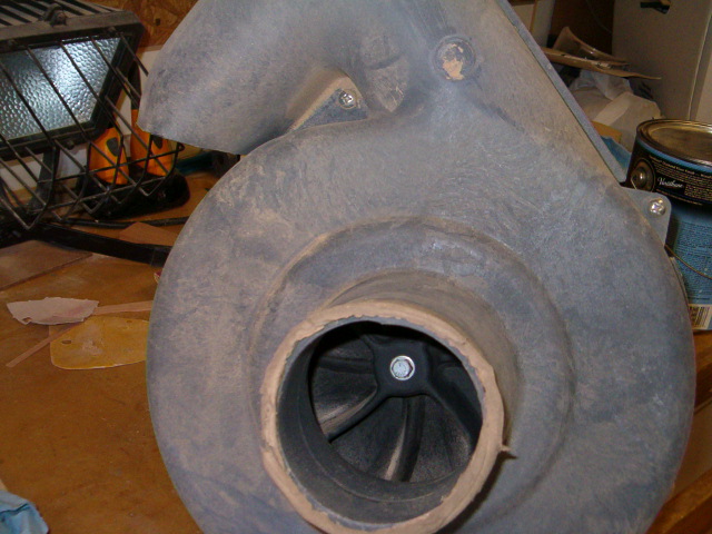

Shoot!!:mad: I took it apart again today, as there are not current projects happening and had some time. Evidently I clicked the higher quality photo after snapping the first one. There are 8 photos in my computer. I can send them by e-mail to anyone wanting them.
Don't really understand the methods of reducing the pixels to make the other photos fit. To be totally honest -don't want to learn either.
But anyway, here is the first photo. It shows the inset side of the guts as the part is on the bench. Note the screw that is almost hidden in the recessed part - just below the fan outlet. This is hard to find, if you didn't know it was there.
Tony - Yes when the unit is all assembled, the yolk does not fit snug up against the front. I thought my unit looked the same as yours, but not so! A closer look at yours shows you do not have the yolk in place. There is supposed to be foam between the manifold and the fan housing intake. When you put the manifold on it protrudes through the opening and is supposed to compress the foam mounted on the inlet as shown in the my one photo photo. The yolk that tightens down the fan unit does not touch the front of the collector body. Give me your e-mail (PM) and I'll send the photos. Your situation is not harmful however. The opening just creates a bit of recycling of dust, and probably a little loss in static pressure and air movement through the hose.

[ATTACH]1453[/ATTACH]
- Guts out - Intake with foam.jpg (121.9 KiB) Viewed 14697 times
