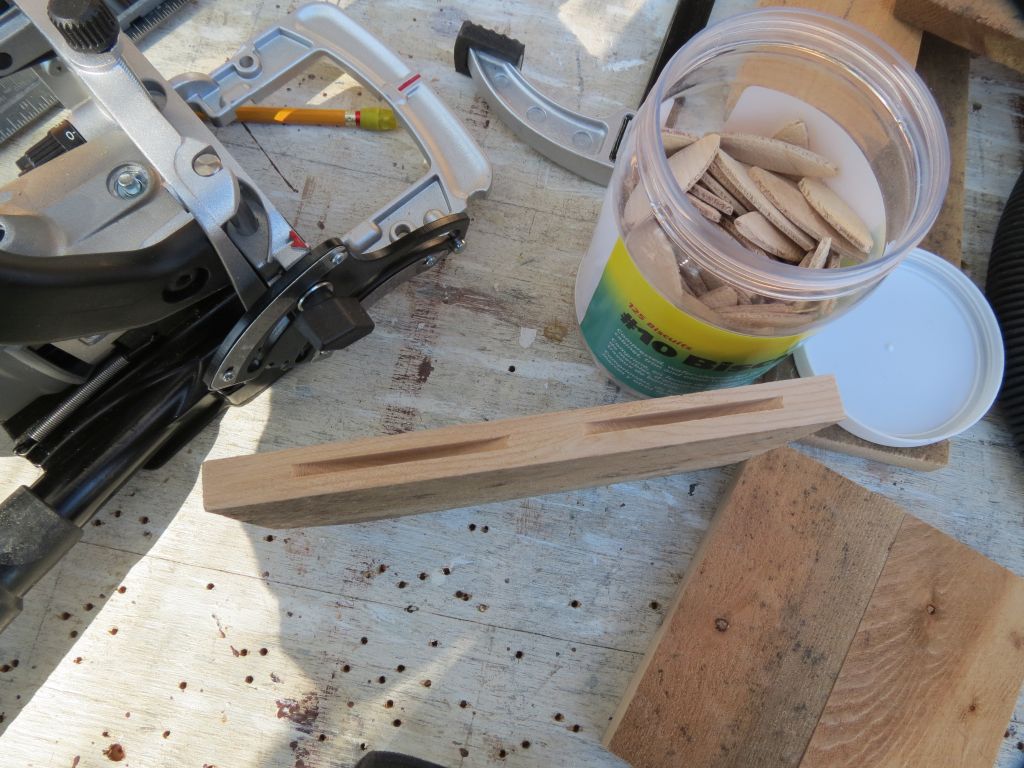

I needed to join some wood strips to make wider boards so for some of the places where things might show I used my PC biscuit jointer. As you will no doubt know this is a pretty easy process but you do need to decide and mark where the biscuits go. So here is a picture of that having been done.
How ever there are other ways of making this same sort of joint, and if you watched some of the later episodes of new yankee workshop, I think it was the kitchen project he showed how the pros sometimes do these.

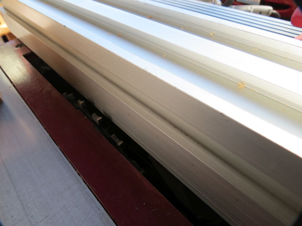

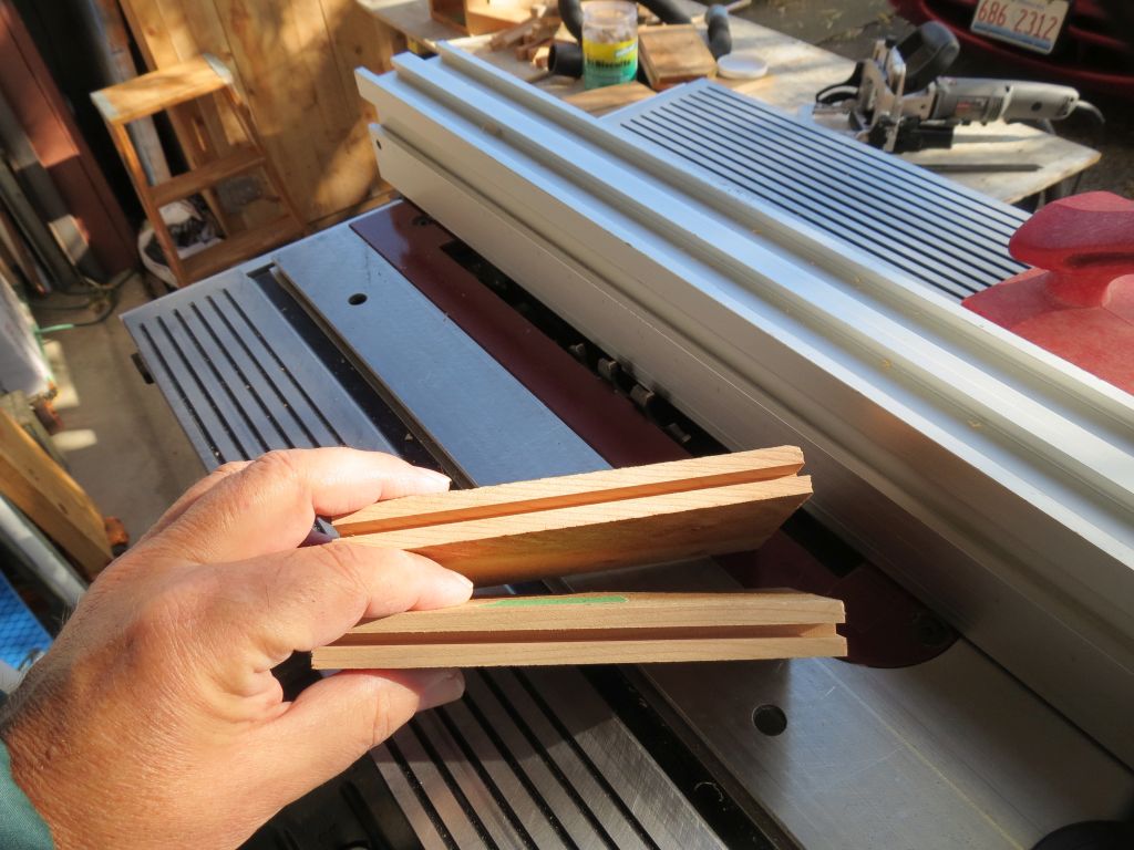

First it takes a special table saw blade that cuts the 5/32" kerf. I have one mounted here.
The idea is to make you cut full length and be able to put the biscuits any where you like along that line and you don't have to mark anything.

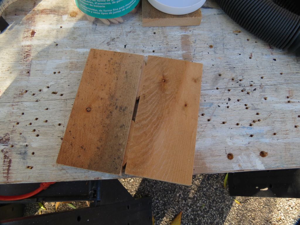

Here is a sample of the cuts.

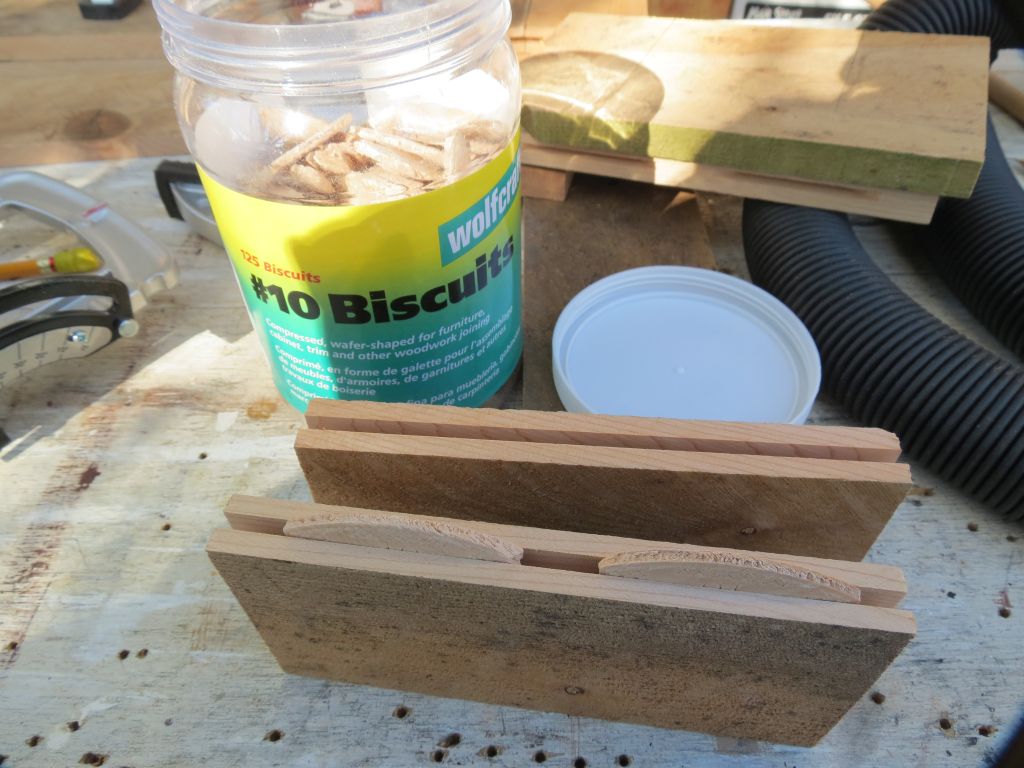

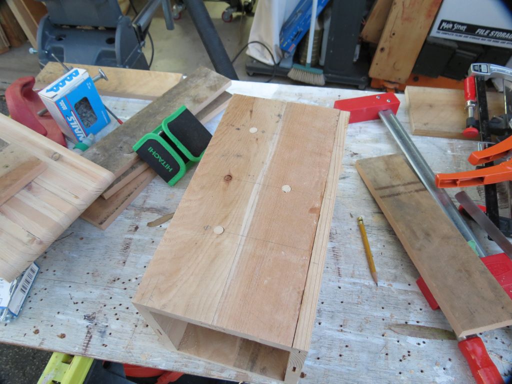

I had the depth set for #10 size biscuits. This was a dry fit test to make sure things fit.
You simply glue them up just like always.
For the box I went with a cut like this because the ends would not be visible but there are places this would not be the right way to go.

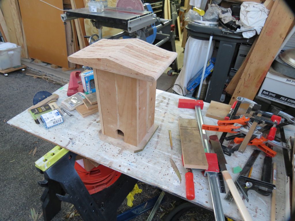

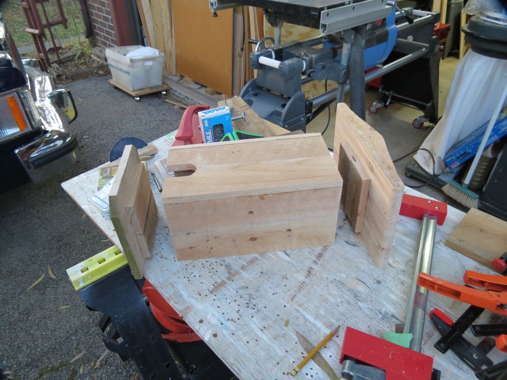

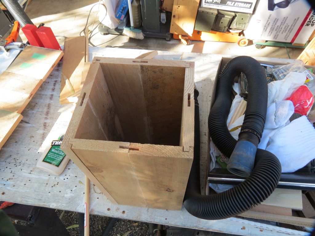

With the boards glued and dried I then proceeded to make it into a box. This was done in a round robin method rather then a front/back, side/side method because I went to test out this for another project I'm thinking about making. For this it would have looked more finished the other way but heck this is for the birds anyway.

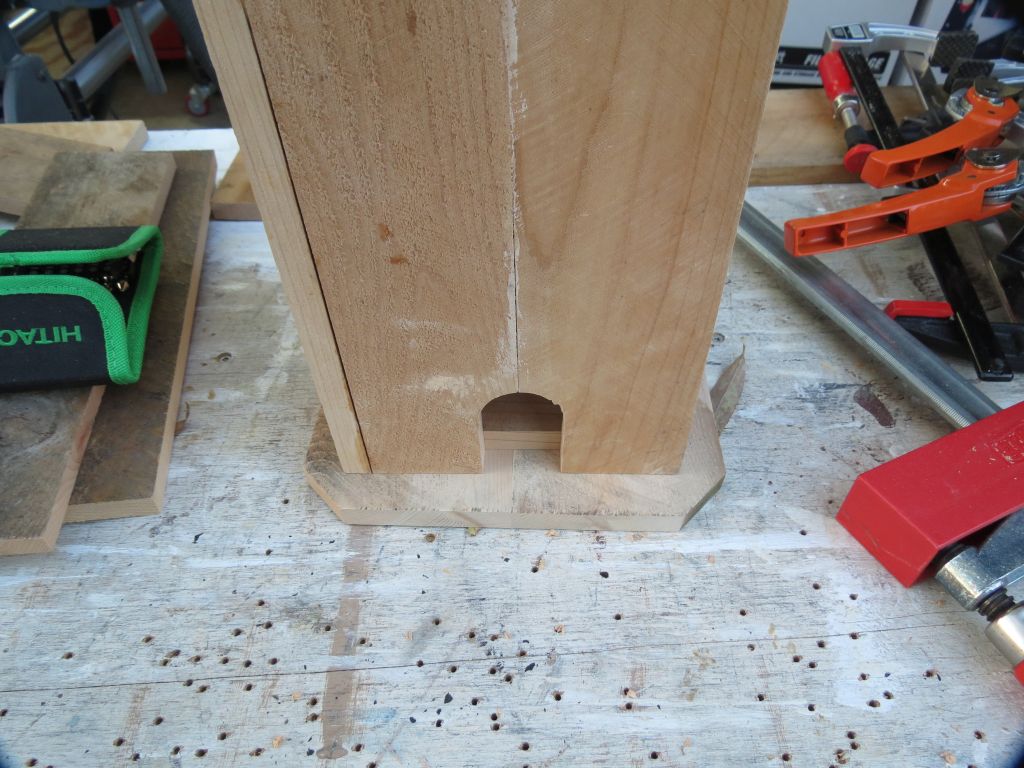

Before putting it together I wanted to make the hole. They recommend the hole to be at the bottom, heat rises and all that stuff. I went with 1-1/2" making it for smaller birds. Used the bandsaw to make the mouse hole look.

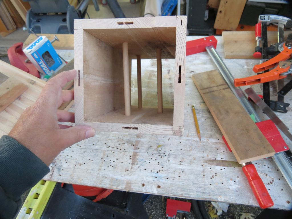

The top and bottom are made to fit inside for mounting reasons. They also recommend that you have no vents or drain holes so that is how I went. Here you can see how it all comes together.
For the roosts I used a 7/16" dowel I had on hand. Some people used smaller and some used larger but since I had that on hand I went that way. I put in 3 levels and made sure then didn't line up as was recommended. Even this way I don't think you want to be the bird on the bottom rung....

How about a peak inside?
Sure no problem.

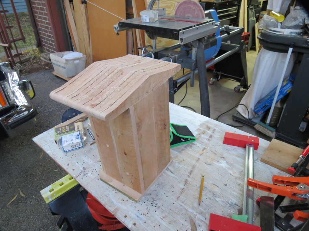

Now lets finish with a front and rear shot of it all pretty much together.
Can't answer many questions on these boxes yet but if you want dimensions and other details let me know and I can tell you what I did, be that right or wrong.
