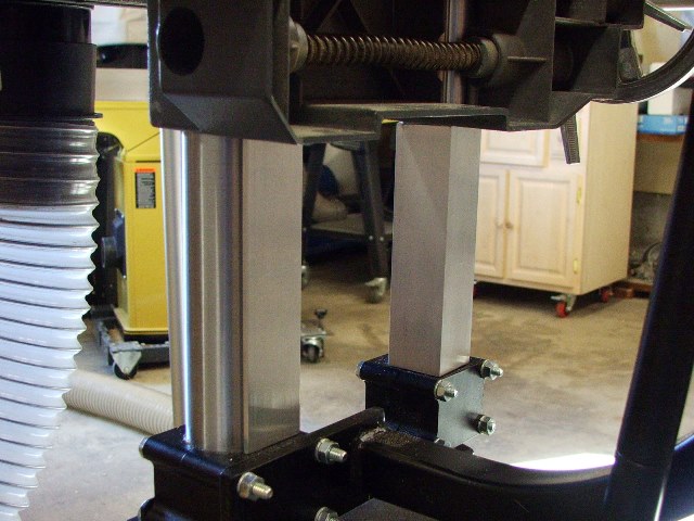

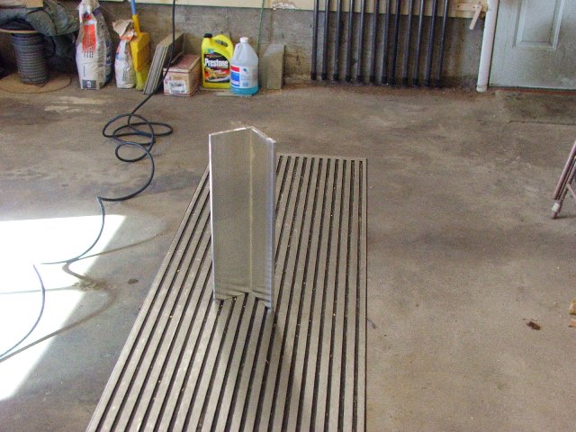

Here is the solution I came up with before my dedicated MK V drill press. It is just two pieces of aluminum angle stock of an appropriate length for a comfortable table height. Set them around the way tubes on the pivot base and drop the table down on top. That and the telescoping legs and the table will not move.
I will say however I never really had a problem with the carriage moving during normal drilling. I used them mainly during hollow chisel mortising as extra insurance. I agree that the carriage locks need to be cleaned and properly adjusted.

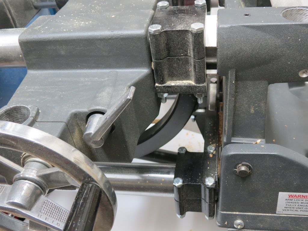

In this first photo the lever is in the unlocked position. The carriage moves freely and the handle has no pressure on it.

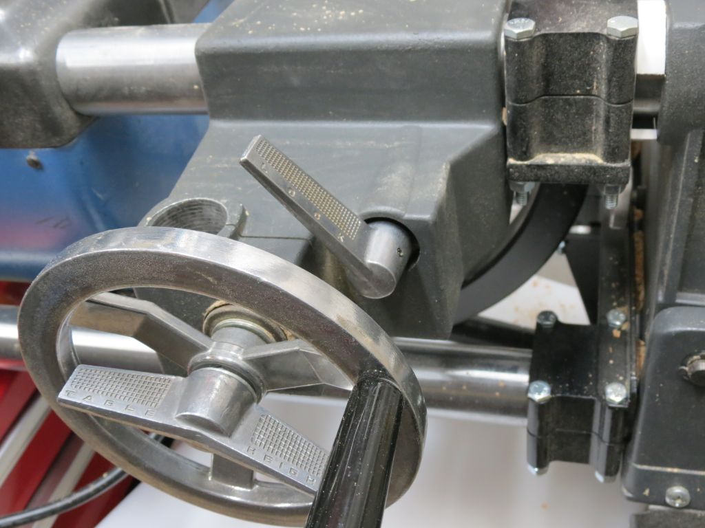

This second photo shows where I start to feel resistance. While the carriage no longer moves freely it certainly would not lock or hold in this position.

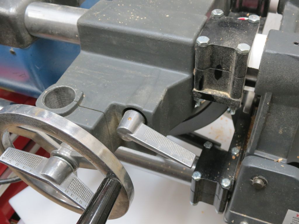

This third shot shows the lever in the locked position. It takes some effort to go this far but once here the carriage is not moving.

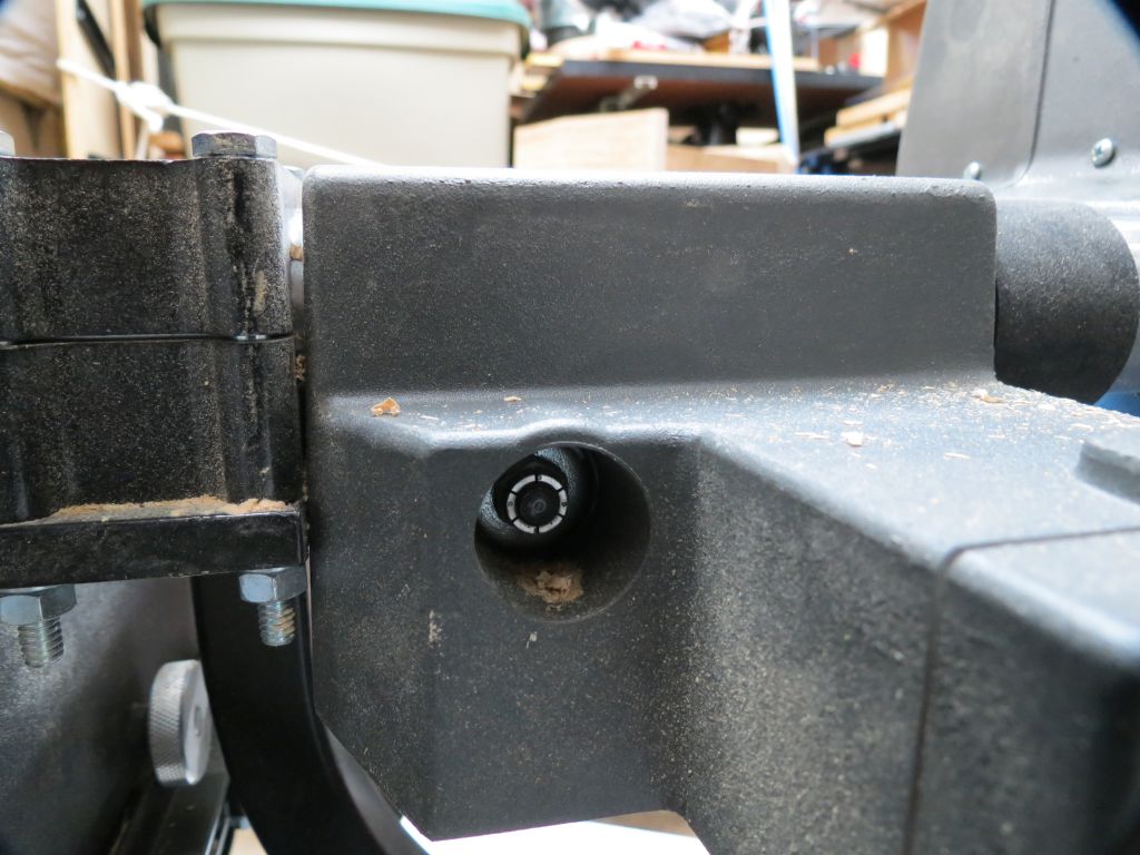

The nut that controls this is on the opposite side and recessed. Socket might be your best bet.
If you can't get the lever to the locked position then it is already too tight. If it moves to easily then it needs to be tighter....... but it would really have to be out of adjustment to have it need to be turned a quarter turn.
Keep in mind the lever goes from loose to tight in a quarter turn........... So just a slight turn makes a large difference. Often it takes a little fiddling to find the sweet spot but when you do you will feel the difference and it will work as intended. I find it easier to get it too tight then back off until I can lock the lever.
This is how I set up my machines and I do not have the slipping issue.
