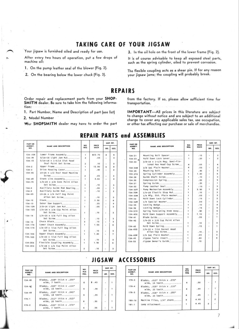

godavid2
Posts: 175
Joined: Tue Oct 09, 2012 10:11 am
Re: File-Pillar Shape???
Post by godavid2 »
I found them in my jig saw manual, thanks again.

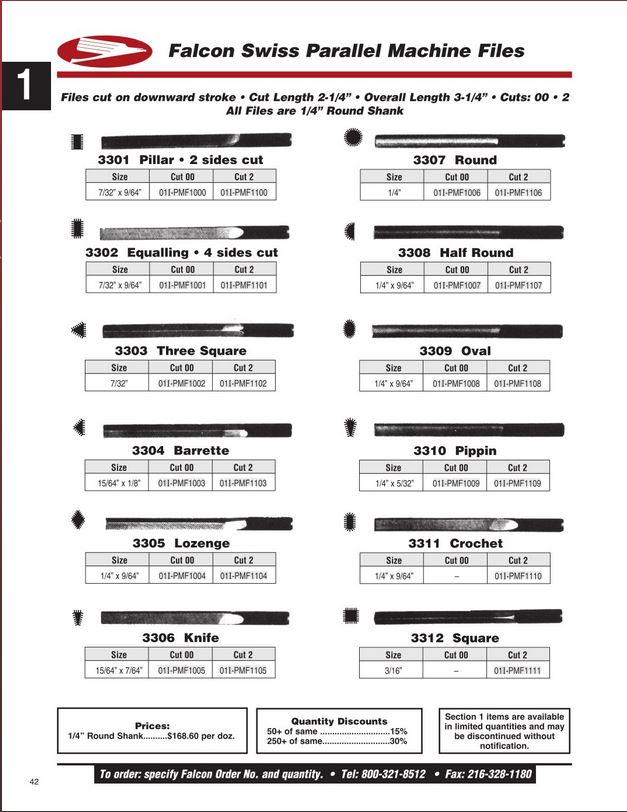

You can still buy them, just not Shopsmith-branded. The generic name for them is "parallel machine file". Google that, and you'll find some vendors. Then you have to sift through those to find the little 3-1/2" files with 1/8" shafts. I think the 1/4" shafts will work also. I did that a while back, and found some NOS files for sale pretty cheap. But that source has dried up, and new ones appear to run about $12 - $14 each.
Here are a couple of sources:
http://www.artcotools.com/parallel-mach ... ype-b.html
https://www.falcontool.com/Section-1/Pa ... hine-Files
