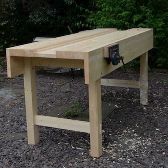

I have a model 510 and I am ripping laminated 2x4's 3' and 4' in length to remove the bevel between the two. I am taking about 3/32 off the 2-15/16. The infeed and outfeed between the blade and fence are exactly the same. However the board still pinches/binds about 8" in. After checking the 1st board passed though the infeed and outfeed measured 3-5/32 but the middle was a frog hair short of 3-6/32. This bogs down the blade which I have the setting at "R". The bogging of the blade is my concern not the 1/32 difference.
The only thing I can think of is that the fence is bowed in the middle. Purchased the SS pre-loved and perhaps it was abused.
Thoughts on correcting and/or proceeding forward would be appreciated. BTW, I am making a British Joiners Workbench per Paul Sellers.

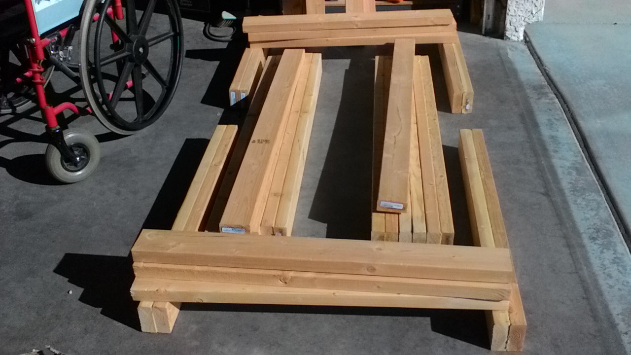

Ron, great job on your bench, also like the shift of the tool well. Doing laminates for turning the last few months and most of the kinks are worked out. Purchased Kiln-Dried Douglas-Fir Dimensional Lumber for my project.rpd wrote:I built one of those benches back in 2011. Woodwork bench build

Never used a plane before and was hoping to stay clear of it which is the reason of the direction taken. Paul Sellers is awesome and swears by the Stanley #4.
