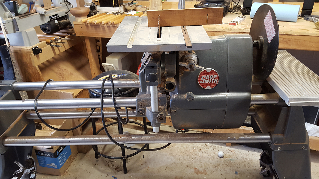

So I have just inherited my grandfather’s Mark V and moved it from Storage to my workshop. I was so excited that my Uncle had given it to me and I am looking forward to passing this down to my son at some point. The problem is that when I got the shopsmith I started to turn stuff to see if there was anything that was seized. One of the things that I turned was the speed control. Now I am afraid to plug it is since they say not to turn the speed control without it running. What is the safest way to get the speed to where it was? I don't want to plug it in till I make sure that I won't damage anything. The speed knob only went so far before it stopped turning but I could see by the dial that it was still in the mid-range of the setting scale. Someone please help. I would hate to think that the first day I get this after so many projects done by my grandfather and I am the one that destroys it.

I think you will be fine, made the same mistake, put the sanding disc on and turn the disc by hand, that should let the sheaves move to the position they where moved to by the speed changer. Then just cross fingers nd turn it on.
Re: broke the number one rule. Now what.
Welcome to the forum Italian. First thing to do is put a sanding disk on the quill, use that for turning the innards, while ya slowly turn the speed control down to "slow". Then it's time for clean up, waxing, lubing and a alignment.

A fine looking early Shopsmith Inc. machine.ERLover wrote:I think you will be fine, made the same mistake, put the sanding disc on and turn the disc by hand, that should let the sheaves move to the position they where moved to by the speed changer. Then just cross fingers nd turn it on.
Fear not! The fact that 'it stopped' means you did not force it. Spin a couple turns with the sanding disk, then remove it before turning it on.
Keep this episode in mind when adjusting the speed towards slow and do so slowly.
Lube it soon.
All the way to slow is is good, but not necessary at this time assuming it will run.
P.S. I think the miter gauge 'extension' board is mounted either reversed, or it was intended to be used in the other slot.

Thanks everyone for the posts. Sorry for the stupidity but I am really new to the ShopSmith so here are some stupid questions ( I tried to stay up late last night reading the manual but I fell asleep)
Beeg - Is the sanding disk on the quill or do you mean where the table saw blade is now? Can I turn it where it is or must I move it.
JPG - I have looked at some of the You Tube videos and will be lubing it before I turn it on. What is the gauge extension board? Told you I was a nube.
Also can someone tell me a little about this Shopsmith, like how old it is and if I want to get parts is there a model that I should be looking for? I do not have any of the parts for the lathe except the "A" shaped tail piece or the chuck for drilling.

Does not make a difference where the disc is, just its large diam gives you leverage to turn the spindle.
Miter gauge wood extension is that piece of wood attached to the miter gauge to give it more surface length. In your pic it is sitting on the table saw table.

If you are facing the SS by the swithc, on the power head, by the lower spindle to your left there is a SS emblem and the S# is on there.
