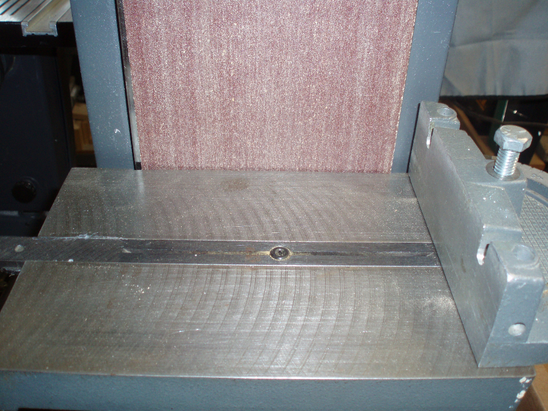

I am not certain about what you are attempting to do that does not work.jonesuh wrote:I have a 520 table system---I think you can attach the Miter gauge to the belt sander table & tighten it down to attach a jig -- but it doesn't on mine---do I need a special miter bar ?
Does this photo image depict your belt sander table and miter gauge?
Does the miter bar on yours have the tapered screw that is seen here in my miter bar?
Please ignore the bolt in the miter gauge.
- Belt Sander 001.JPG (1.38 MiB) Viewed 3946 times
Re: Miter Gauge ?
yes it has that but not sure the screw is the right one it screws in with the hex wrench but doesn't tighten the bar ---don't know if I'm missing a piece---i'll check the exploded parts list
Re: Miter Gauge ?
There is nothing but the screw. However it is a tapered screw so it spreads the bar when tightened.jonesuh wrote:yes it has that but not sure the screw is the right one it screws in with the hex wrench but doesn't tighten the bar ---don't know if I'm missing a piece---i'll check the exploded parts list
Re: Miter Gauge ?
Speculating on source of confusion: There are two holes in the belt sander's miter slot. I believe these are for attaching jigs. The miter bar itself tightens in the slot simply by turning the tapered screw as stated by jsburger.
