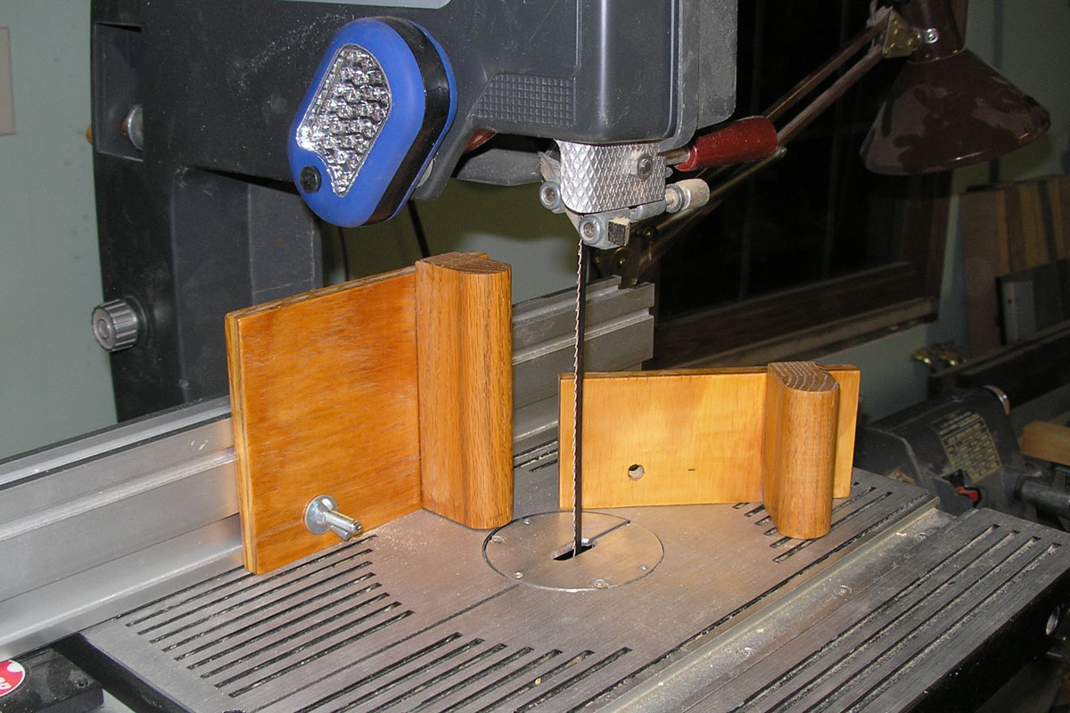

A 't-bolt' is a bolt which slides into a miter track (e.g. on top of the 520 fence or, in my case, the miter track on the side of Kreg bandsaw fence) and can then be used to secure 'stuff'.
I was adding a shop made re-saw guide to my Kreg and needed a T-bolt to secure the new guide to the fence. Shopsmith sells a very nice version (PN 521665 - a set of 4 for $21) but I wanted one right NOW!! And saving a bit of money wouldn't be all that bad.
Resaw Guide
Resaw Guide

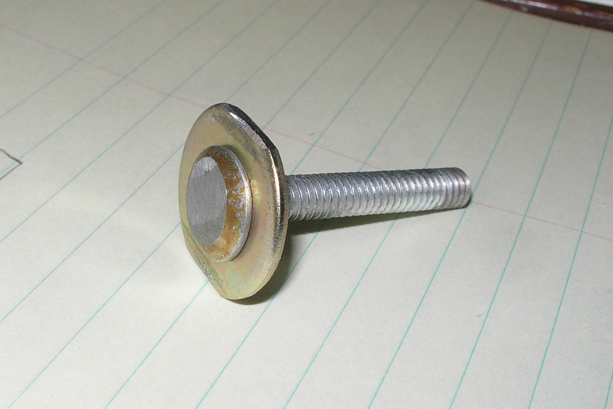

So I got a 1/4-20 carriage bolt and a 1" OD (1/4" ID ) fender washer from the local hardware store for about $0.75.
Carriage bolt and fender washer
The carriage bolt has a square protrusion under the head which wouldn't quite fit in the 1/4" ID on the washer - I hit the hole in 4 corners with a file and then, with the bolt in place, I whacked it with a hammer to drive it in place. The fender washer is a bit larger than a miter T-track (which is about 0.934" wide) but a bit of grinding on the sides took care of that. The washer plus the thickness of the bolt head was also a bit thicker than the slot height (0.130" for SS miter track, 0.175" for the Kreg) but again the grinder too care of that.
Finished T-Bolt
Finished T-Bolt
Works very well and certainly didn't cost much.

Re: Shopmade T-bolt assembly
Hmmmm. Elevator bolt?
Posts: 3812
JPG wrote:Hmmmm. Elevator bolt?
Maybe -- they're cheap enough, and my local Lowes stocks them.
Do you think that bevel on the underside of the head would be a problem? It would put all the clamping pressure on a couple of small spots underneath the lip of the miter slot.
I think not(assuming thee is not a gorilla).
Wing nuts help prevent gorilla forces. Especially the stamped ones.

bobgroh
Posts: 400
Joined: Sun Jun 29, 2008 1:12 pm
Location: Just east of Kansas City, Missouri
Post by bobgroh »
I think the 'elevator bolt' would work fine! I'll have to look for those. And I don't think the contact points would be any problem - as someone else pointed out, you don't put a lot of pressure on these. So another solution and even simpler!! Love it.

Lee Valley has the 1/4-20 1" T-bolts, box of 10 $3,20 US. 1/4-20 T-Bolts and T-Slot Nuts
rjent
Posts: 2121
Post by rjent »
rpd wrote:Lee Valley has the 1/4-20 1" T-bolts, box of 10 $3,20 US. 1/4-20 T-Bolts and T-Slot Nuts
Have you used these in the SS fence/table before?
Dick
1965 Mark VII S/N 407684
1950 10 ER S/N ER 39671
1951 jigsaw X 2
1951 !0 ER #3 in rebuild
rpd
Posts: 3045
Location: Victoria, B.C.
Post by rpd »
Sadly none of my equipment is new enough to have t slots in the fences, so no personal experience.
T-slot extrusions are pretty much standardized and the OP said he had used 1/4 20 bolts.
The heads on the 1/4 20 T-bolts measure .720x.508x.095.
If a wider head is desired there are 5/16 18 T-bolts, they measure .832x.508x.095.
