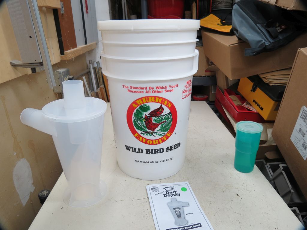

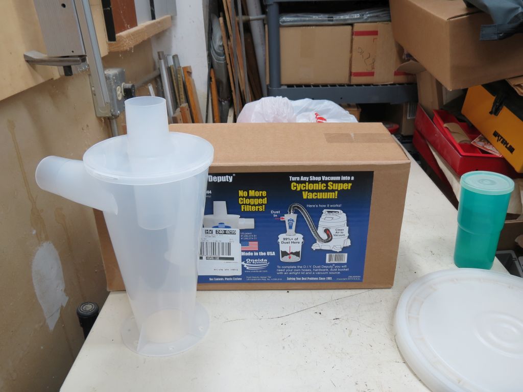

I've been thinking of getting a second one for my other shop vac so since I was in the store for a few other things I picked up the DIY version.
These are really a must have in the shop and for $39 and some minor labor it is great deal. You will need some other "stuff" but it is possible you already have it in your home or shop.
I will show you just how easy this is in this post. The DIY kit is of course required to get started.
You will also need a bucket or other container, in my case I went with an old #40 bird seed container with lid. You can make your own lid but it will have to be air tight so keep that in mind. Containers can be bigger or smaller depending on your needs.

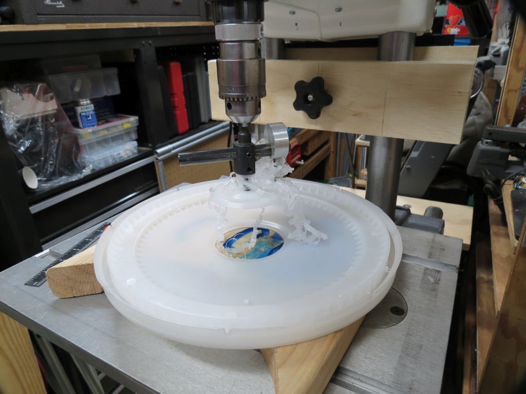

The lid will need a 3" hole cut in it. This is how I did mine.
I'm really liking the powerpro for a drill press, so nice to dial down the speed for this type of cut. Yes the speed reducer works but then you have to add it and take it off etc etc.
A hole saw or other method of drill is fast but one could cut it with say a jig saw or by drilling a bunch of holes on the circumference or any number of other creative ways.

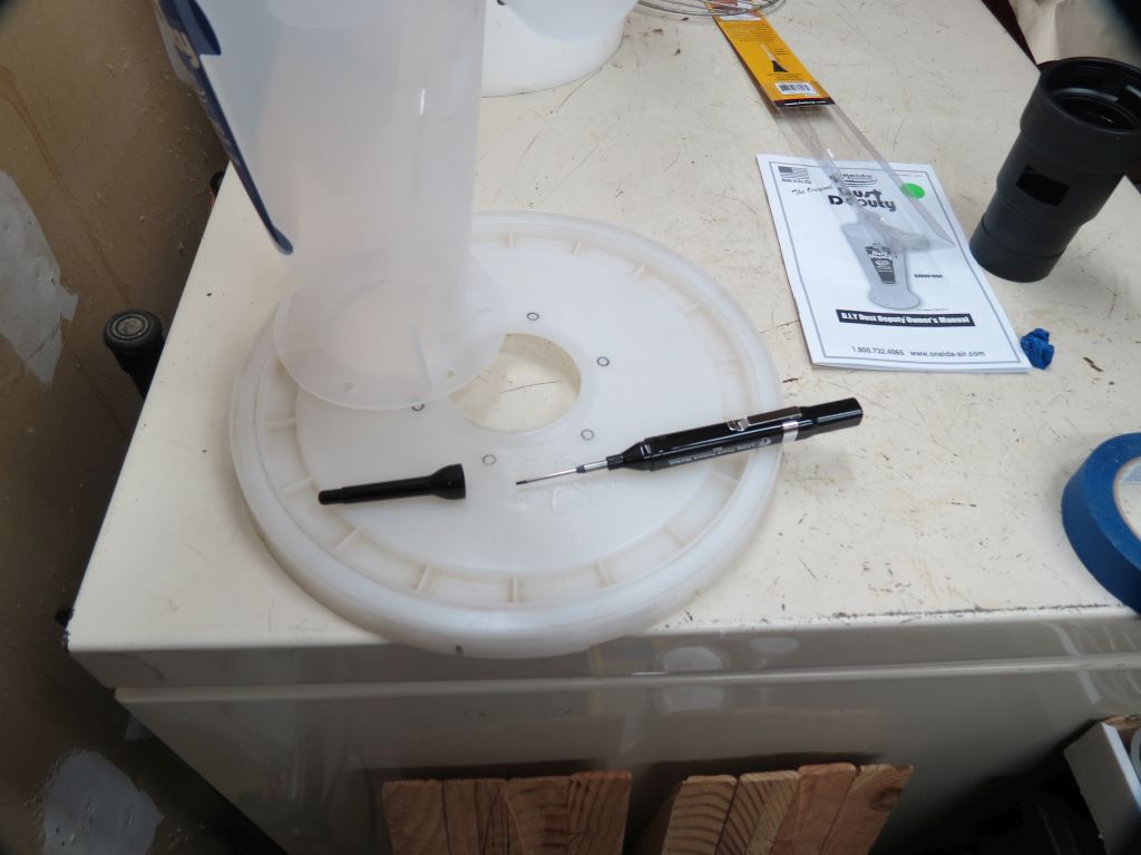

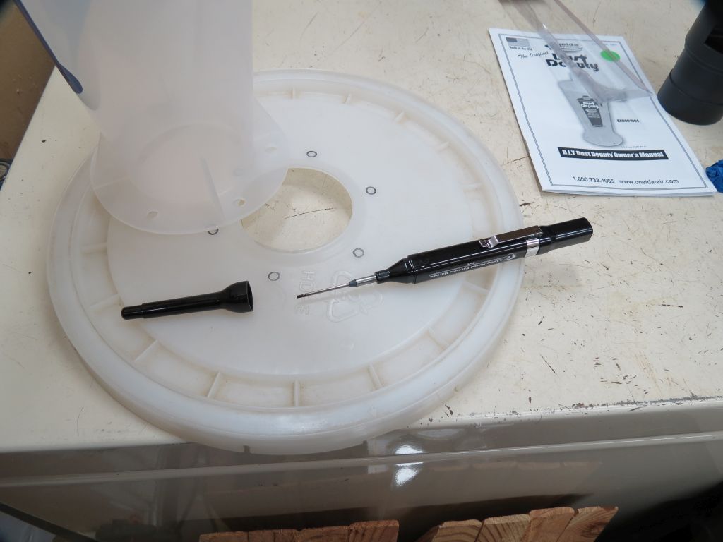

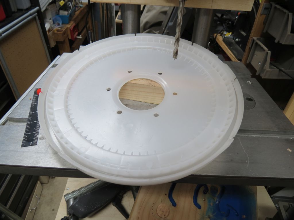

You also need to drill the mounting holes. I used a marker to mark the location of the holes.
These markers with the thin long tip are great for this sort of thing.
Then it is just a matter of drilling the 6 holes.

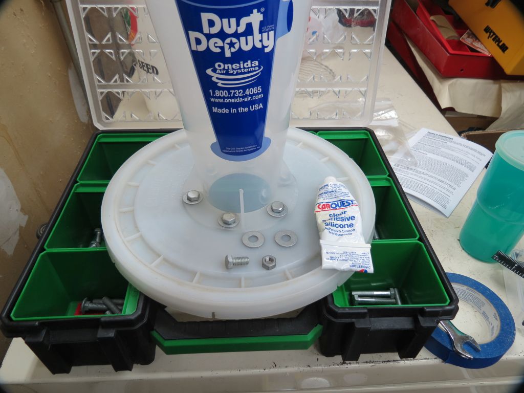

At this point you are ready for assembly. I went with some 5/16" hardware, the bolts are 5/8" long which is perfect, you might not find them in a hardware store but longer is not going to hurt anything. The sealant I used is what I had on hand. You need to make it air tight so use what you see fit. The other one I got as a kit came with a gasket but it takes longer to make a gasket then just squeezing on some gooey stuff.
The thing needs to set for a while and dry before I start it up.

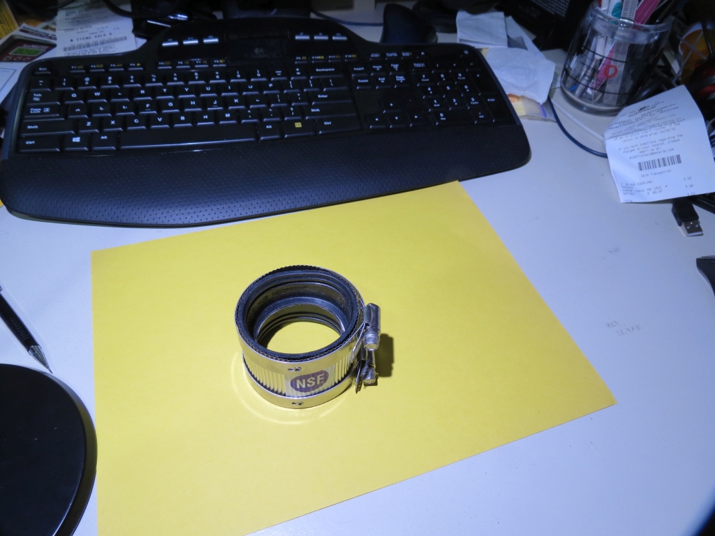

I think I have a pretty good solution for mating the vacuum hose to the dust deputy. I was in the hardware store and found this coupling that is titled 2" NO-HUB coupling for $3.59. The hardware guy said that it was used for metal pipe(cast iron) to metal pipe(cast iron) applications. Since the outside diameter of metal pipe is pretty close to vacuum hose size (I do mean really close) this will work were as PVC pipe is a different animal size wise.
I only got one to try and so far it is working really well. Unless I find some down side tonight I will pick up a few more of these for other applications that have been messing with me.
