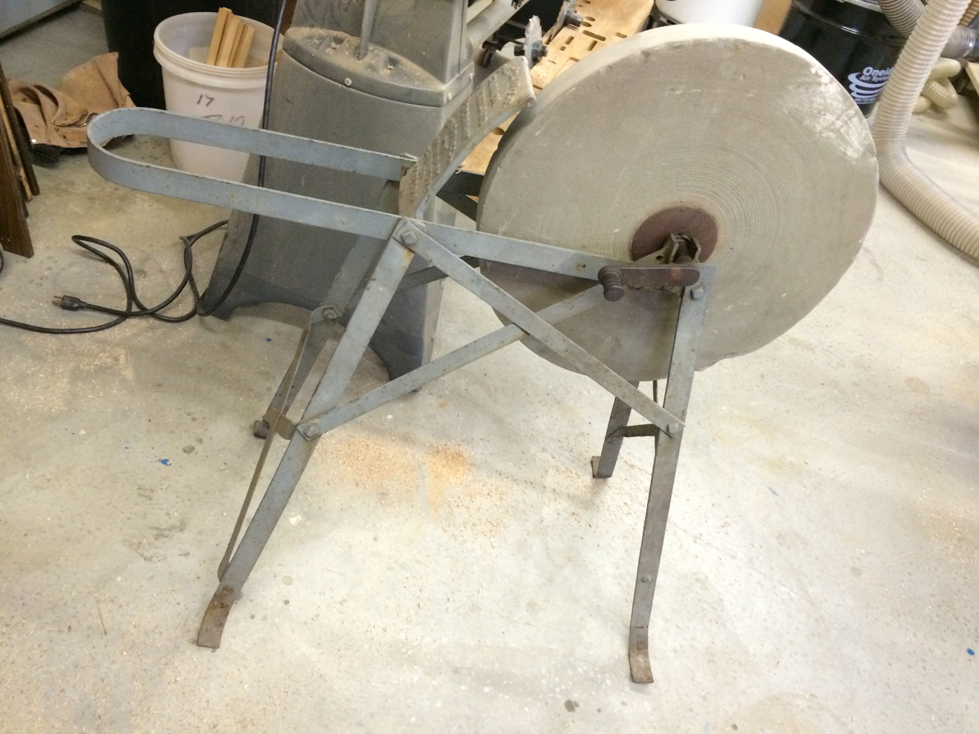

Oh my, thanks for sharing this Dennis! Did you see them sharpening the axe? I picked up a similar sharpening wheel at a garage sale. Why I don't know, I just wanted it. I hope to use it some day.
Re: Harvesting giant redwoods in the 1940's
Just a bigger Tormek!

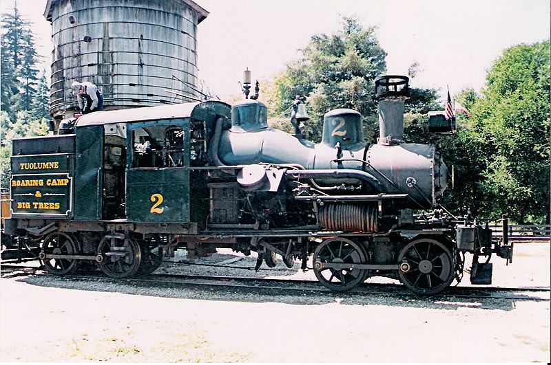

That is pretty much it. With a direct drive piston steam engine you can get more torque with smaller wheels. There is a limit however. Since the crank is directly connected to the driving wheel on a direct drive steam engine its radius is smaller than the wheel and that radius determines the stroke of the piston. If you go too small with the driving wheel the crank radius is so short that torque is lost and the piston stroke is too short to work properly (efficiently).davebodner wrote:Cool. So, I guess the idea for these locomotives was that they were geared so much lower than a normal locomotive. Huge amount of torque at the expense of top speed.
There were three types of geared engines used commonly in North America although there were a few others(clones). The Shay had an off set boiler with vertical cylinders on the right side. The Heisler had V Twin cylinders under the boiler. The Climax had two cylinders, one on either side of the boiler. The Shay was the most common type used. They were also narrow gauge engines.
- Shay Geared Engine
- Shay.jpg (15.86 KiB) Viewed 2795 times
- Heisler Geared Engine
- Heisler.jpg (123.81 KiB) Viewed 2795 times
- Climax Geared Engine
- Climax.jpg (11.82 KiB) Viewed 2795 times
