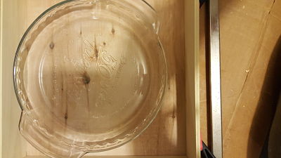

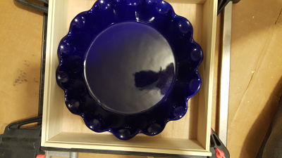

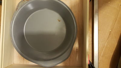

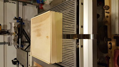

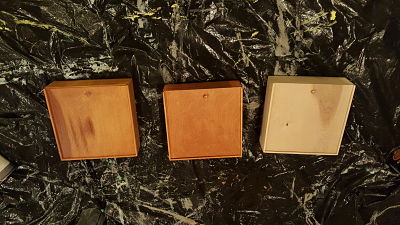

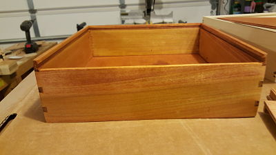

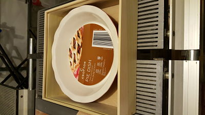

Over the weekend my husband showed me a picture of a pie box and asked if I could make one. http://www.anthropologie.com/anthro/pro ... g.8w__Sg#/ I said I probably can I would just need to get some wood. :rolleyes: Sunday he comes home from a run to the grocery store with .25 in x 3.5 in x 4 ft poplar boards and a 2 ft x 4 ft section of luan plywood. He then asks if I could have at least one done by Christmas for a gift. :eek: I now have one glued up, one stained and one with a first coat of poly drying. After I finished assembling one, that I made sure the pie pan he presented me with would fit, he then asks if the other pans would also fit. :confused: He then gets out various sized pans to try. I did not know that there were so many different sizes of 9 in pie pans or that he had that many. :eek: I ended up making spacers so the smaller ones do not move too much in the box. I was also surprised at the diffent depths of the different pans.

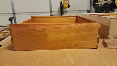

I do not like working with the luan. In several places the top ply is thin enough to see the next ply. I also do not know about the dovetails. I like them in thicker wood but not sure about in pieces this thin. I cut dadoes top and bottom on the boards then cut to length keeping track of which order they were cut so I could wrap the grain around the box. [img]

I could have done a glue up if I had more time and was allowed to choose the wood but hubby bought the wood without me. He thought the luan had an interesting grain pattern and wanted it used. I think if I was to do this again I would almost choose to use a 1/2 in thick sides and a 1/4 in top and bottom. I am not sure if I would use dowels or biscuits for gluing up the top and bottom but both would work.
