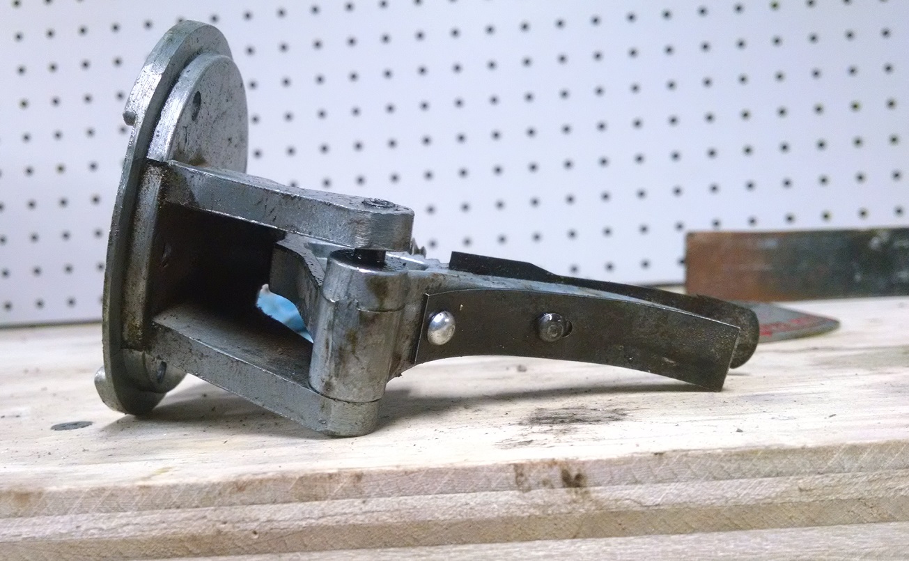

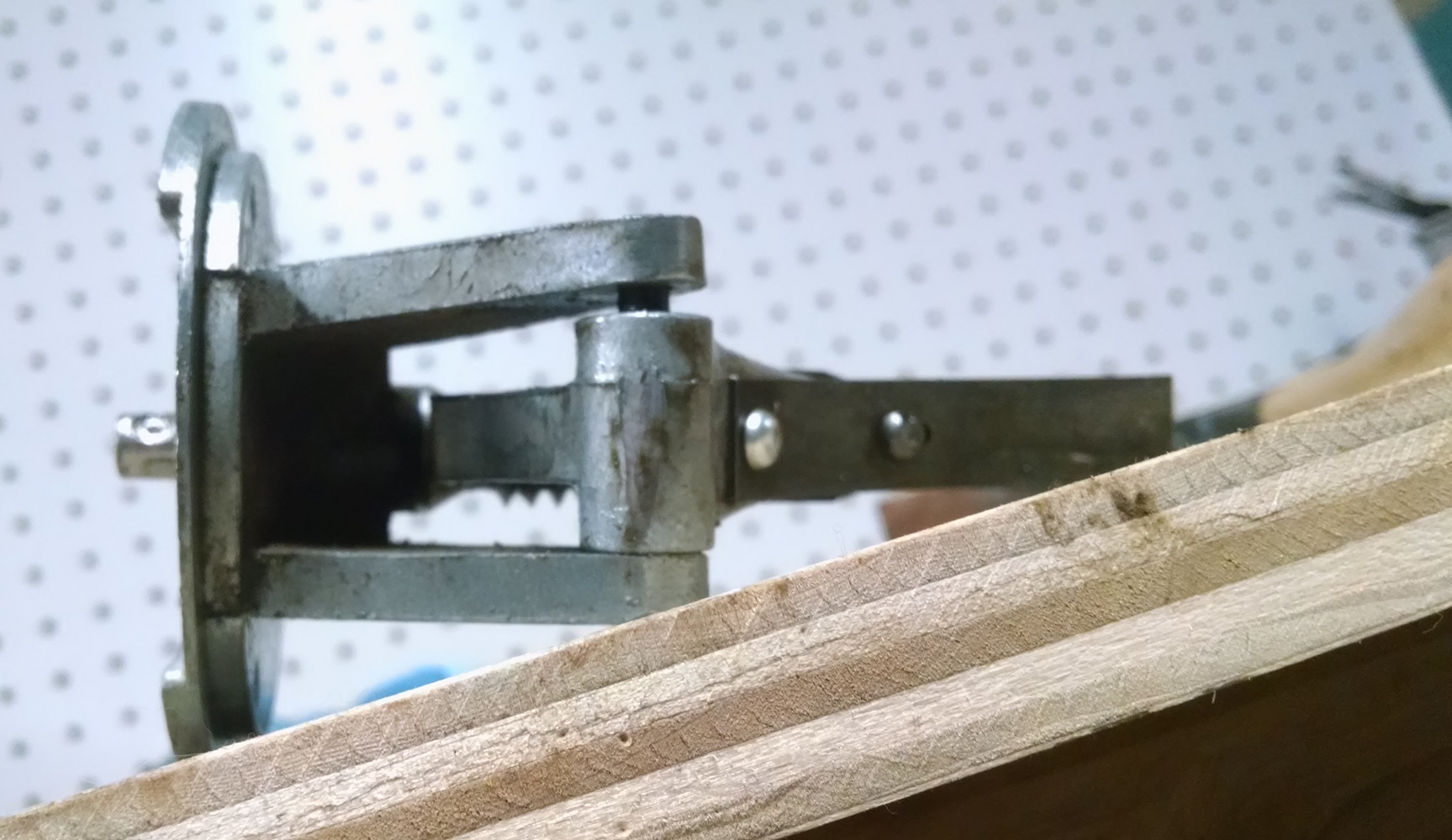

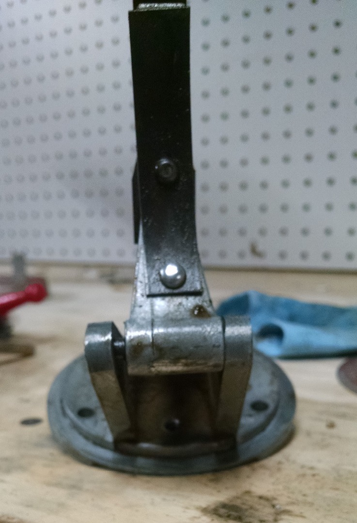

Picked this guy up a few months ago and finally found the time to tear it down. Is the bent arm repairable? I'll probably try it either way since the worse case is I break an already broken part...but any tips or tricks on a successful operation would be appreciated!

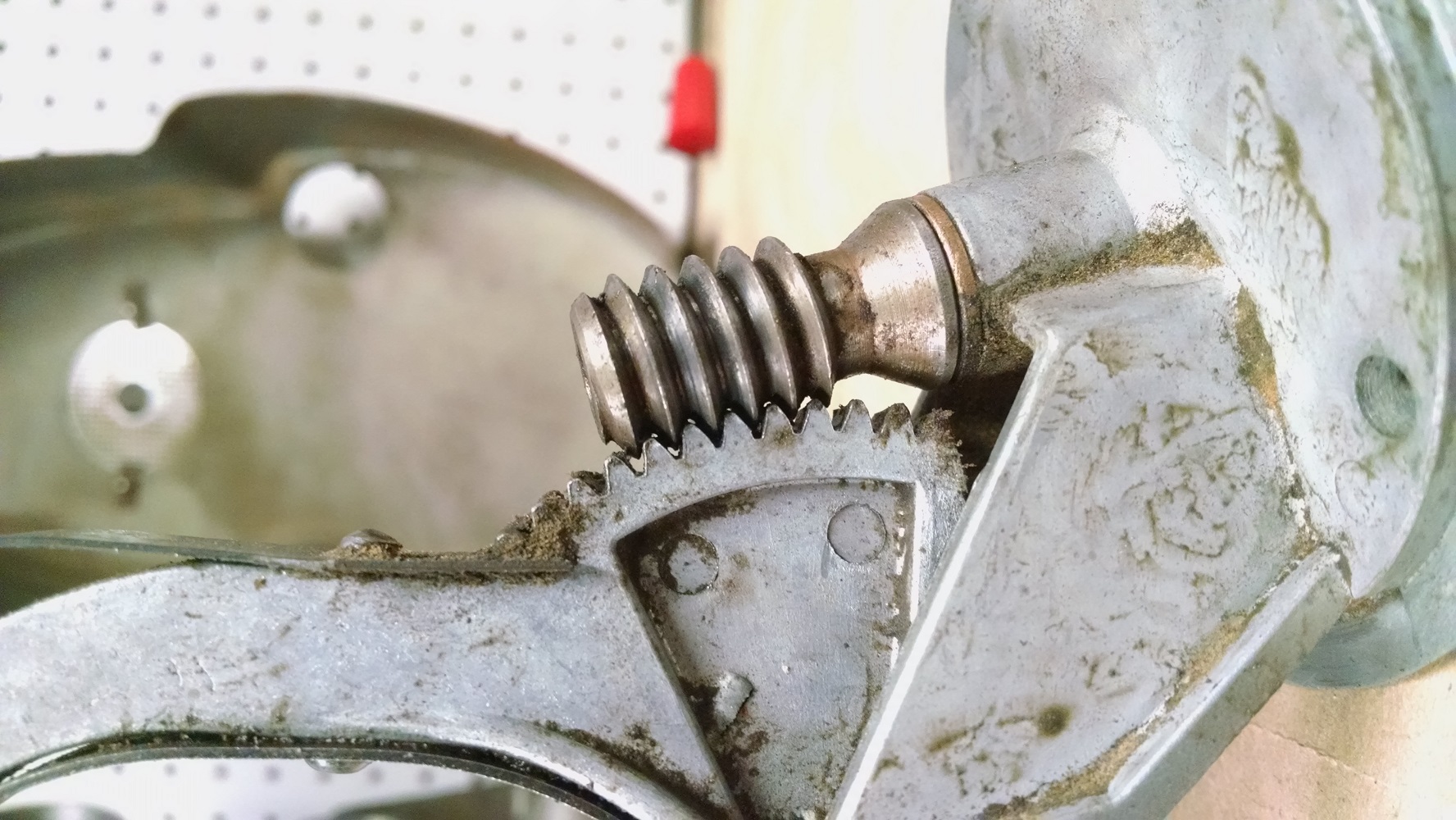

Check with Bill Mayo on this site. He has a way to replace the roll pin with a 1/4" bolt to prevent wear. I have only straightened one of these arms but it was not bent as badly as yours. Can you post a pic of the gears to show the extent of wear on those parts?

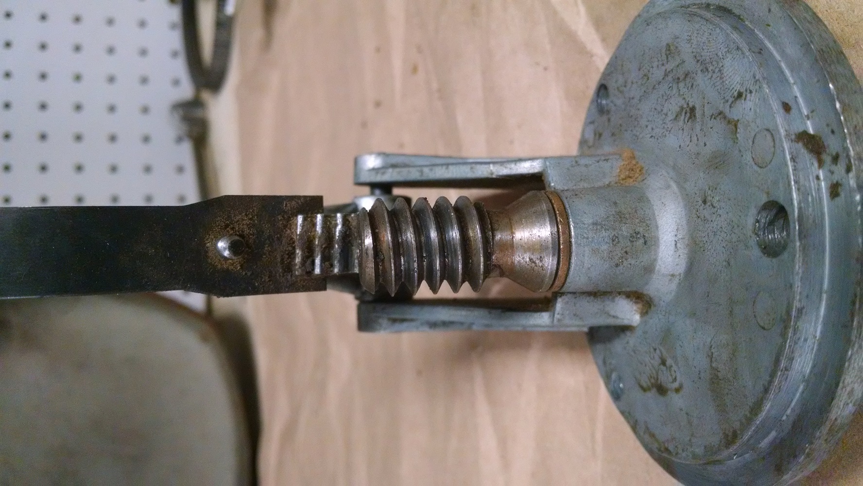

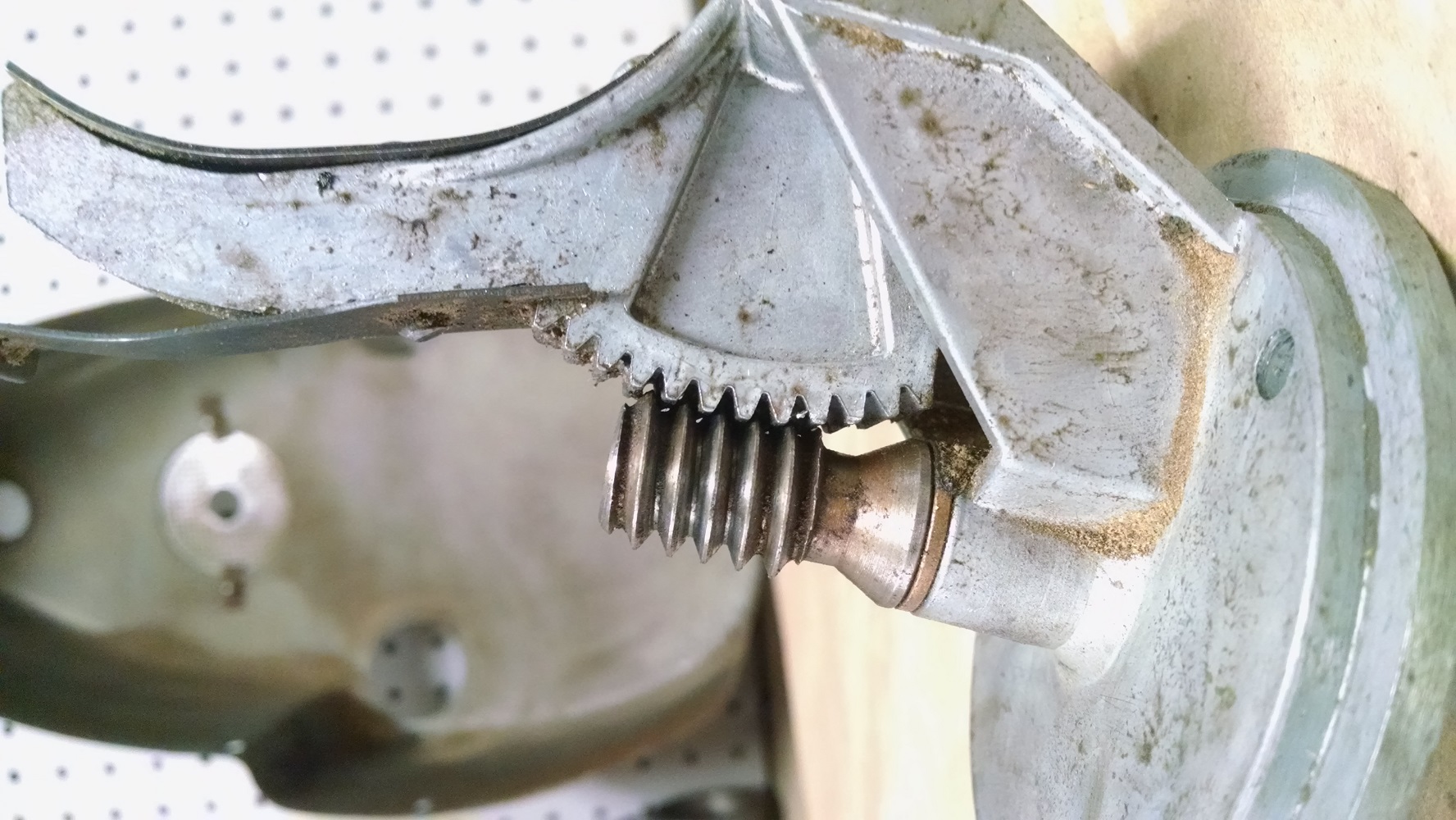

I have been replacing the speed control quadrant roll pin with the following:
10-24 x 2 ½” allen head screw, 2 star washers and a nylock nut. This replaces the roll pin (88) used to secure the Speed Control Quadrant. This prevents the one arm from being bent when changing from FAST to SLOW speed. Over 350 of these bolt kits have been installed over 14 years with no reported failures to me.
If the quadrant teeth are not badly bent or worn (25%), I have been able to recondition the teeth with a chisel and needle file. I only bend the one arm carefully that has been pushed out of position.

I would use a vise so as to both apply straight line force and to prevent sudden over travel. A drillpress vise is good.billmayo wrote:I have been replacing the speed control quadrant roll pin with the following:

I've uploaded pictures of the threads, below. I have no idea if they're worn or not, I am fairly inexperienced with machinery. It WAS very heavily on the side of the unbent arm so the porkchop seems to have some heavier wear on that side, but I am not sure if it's in an acceptable range or if I should replace the whole assembly.
I think I'm going to try to bend the arm back using a vice as suggested by JPG and later replace the roll pin with a screw. There's a lot that needs fixing on this guy so I'm trying to keep the heavier duty fixes/modifications to after I've got everything cleaned or replaced and am ready to reassemble.
