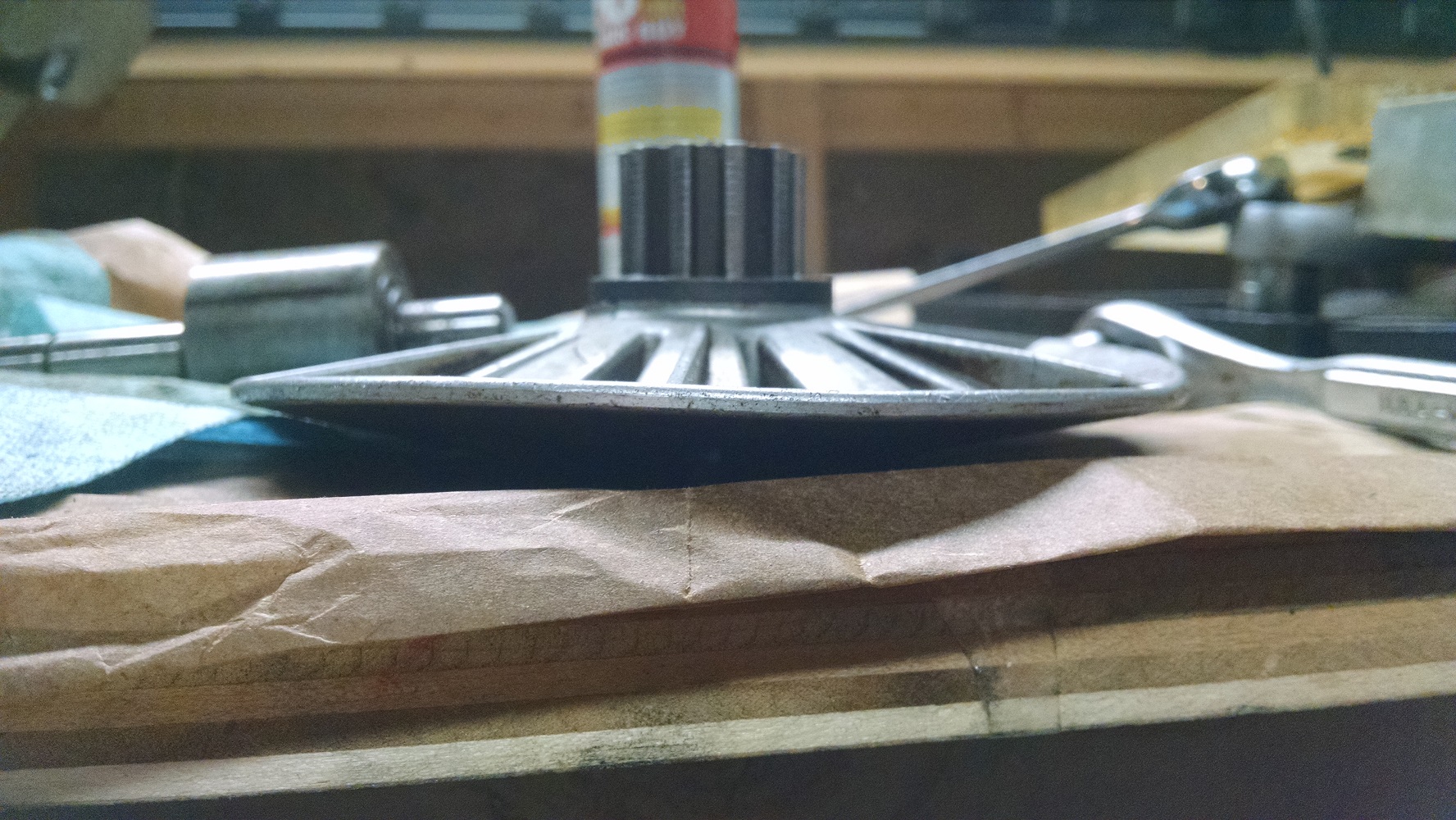

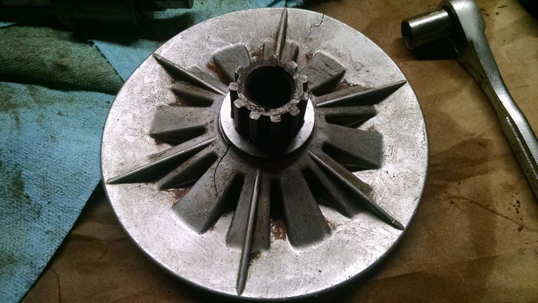

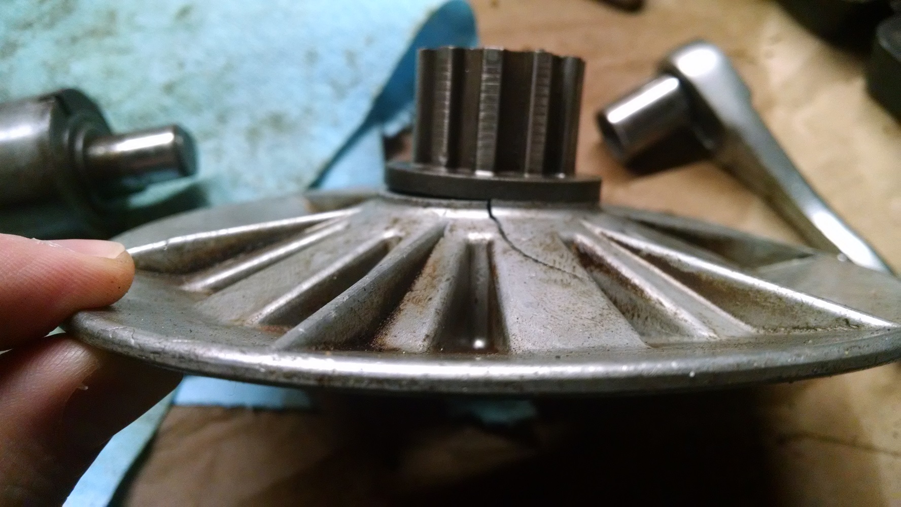

I'm fairly sure the sheave is non-repairable because it's cracked and bent. But who doesn't love pictures? I've uploaded them, below.
Re: Broke my gilmer idler sheave...what now?
Yep the aluminum part is toast, but do not throw it out. The gilmer hub may be salvageable and it may be possible(if one has a machine shop) to improvise a sheave(A bit dicey).
Now how about the idler shaft etc.?
