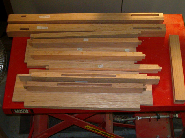

Here's a photo of some mortises I made on table legs. - - Shopsmith's Overhead router is about $450 as compared to $1600 for that horizontal boreing machine. Sopsmith's unit will also work in the horizontal position.
[ATTACH]1481[/ATTACH]
