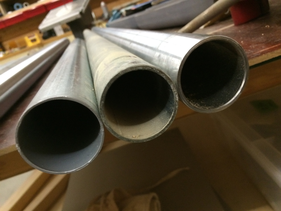

Re: Thin Wall EMT Way and Bench Tubes
Thanks ER. Here is what I bought: http://www.homedepot.com/p/Allied-Tube- ... /100400412
Here you can see it side by side: EMT/Bench/Way
I think the view angle makes the EMT look larger. I assume it is 1 1/2" EMT.tomsalwasser wrote:Thanks ER. Here is what I bought: http://www.homedepot.com/p/Allied-Tube- ... /100400412
If so it is very close to 1 3/4" od.
Make sure the plugs are long enough to be under the entire clamp.

- Posts: 35457
ERLover wrote:Tom, I dont know the inside diam of the EMT, but check that out and maybe buy some oak dowel that is the same size, save the time of turning some.
id 1.610"
OD 1.740"

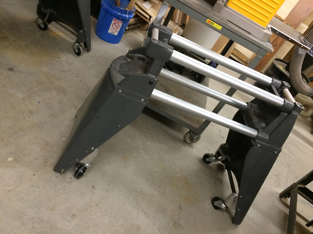

- tomsalwasser
- Posts: 928
- Joined: Mon Feb 08, 2010 2:09 pm
Ain't she cute? I quickly assembled it without the wooden plugs (yet). I was very careful about snugging the clamps. The EMT bench tubes are 26-3/4" and the way tubes are 26". I plan to mount the planer on this excellent SS rolling base, which became available after I mounted my drill press on the wall. I did not cut my SS tubes so can always go back.
