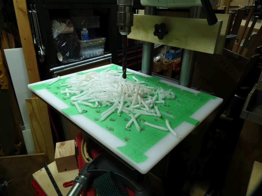

This is a plastic cutting board from Sams Club, forgot the price but it is pretty cheap and pretty much just what I wanted for this project. I have two of them but so far this is the only one that has been drilled. It is fun seeing the twin tight spirals coming off the 1/2" twist bit turned by my powerpro drill press.

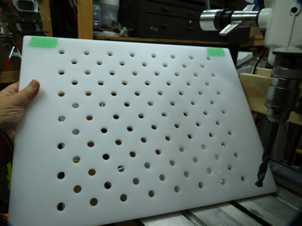

So lets get to some pictures. This is the results of drilling 98 holes.
No I did not let it pile up like that. Just collected the majority of the waste and piled it on for the picture. To bad I can't think of something to do with all those spirals.

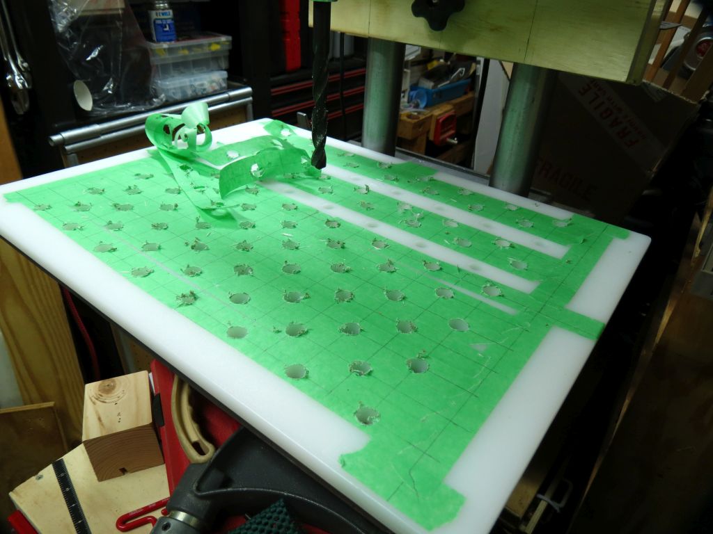

I laid out the grid of 1" spaces and drilled in the pattern shown. Not all that much fun but with out a CNC it all manual labor anyway. I marked the holes to be drilled so I wouldn't mess up while drilling. I used a green masking tape that holds on at least some what to the plastic.
I still need to cut to width so it will fit where I plan to put it but at least all the holes are done.

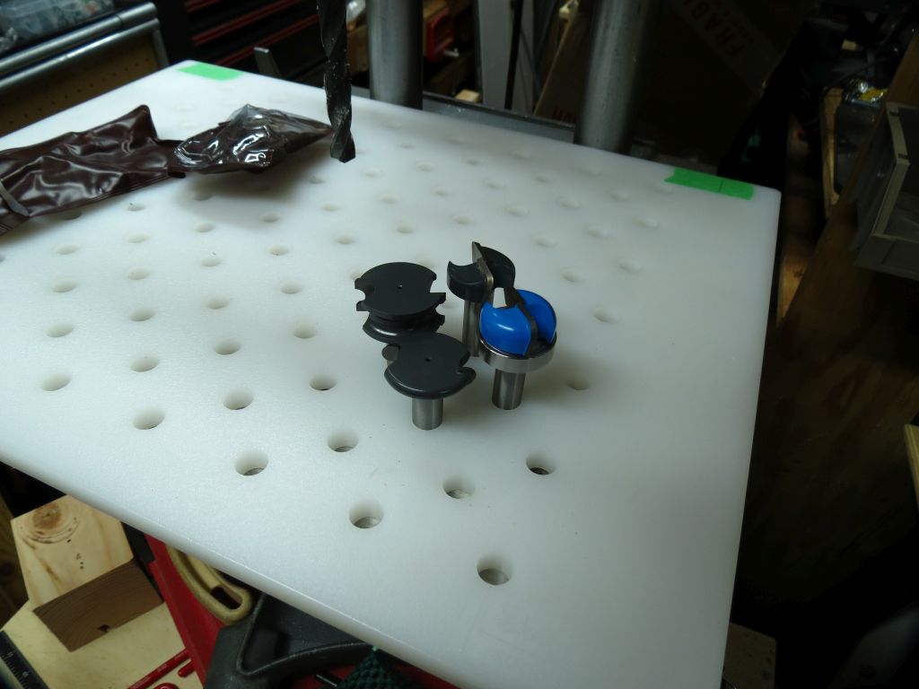

I guess I didn't say what it was for did I? Care to guess?
Were you right?
This one is just for 1/2" bits and the next one will be just for 1/4" but will be more densely packed. Some bits will not fit due to width and some might not need to be in this rack because they are packed well in their own boxes. I have not done a bit count in a while but I do believe it is the range of 300 bits so it will be interesting to gather then in to one place and start putting them in the holes.
