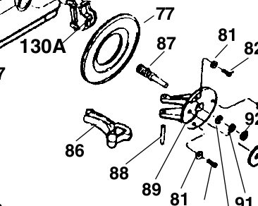

Hi there, I am facing a problem with my 1985 Shopsmith. I've been using my Shopsmith for about 3 years. Over this time I upgraded it into a 520 with no problems until last week when I noticed a weird noise. After reading what could be I removed the quill and both bearing were out, so I purchased a set of new ones and have them replaced in a machine shop; at the same time I checked the drive sleeve assembly and changed the bearings too. While doing this I noticed the belts were in bad shape so I ordered both of them. I followed the instruction sent by Shopsmith and now I have no noise but the problems are: the dial speed is hard to turn it 9 (it was hard in the beginning but now is worse) and problem 2 is that I turn my Shopsmith in slow and as I turn it to fast little by little it just wont speed up; then I turn it down a little and start speeding up but it takes its time to speed up. Any ideas what did I do wrong? I really will appreciate any help anyone can give me. :confused:

I have a 1986 SS and I replaced the bearings and belts in mine about a month ago. I also noticed that the speed control was hard to turn as I checked quadrant assembly teeth. The teeth had a burr on the teeth. I lightly filed the burr off, trying to keep the alignment of the teeth. I back it together and the speed control turns a lot better and smoother.
Remember the teeth on the quadrant are aluminum and the worm control shaft is steel.
[img]
[/img]
check part number 86 - quadrant assmbly
check part number 87 - worm control shaft

A sluggish response to speed control changes is usually caused by the floating sheave(motor shaft) not moving along the shaft freely.
And NEVER force the speed knob towards SLOW.

Hi there, good morning! Today, as soon as I get home, will check the teeth on both items. I really appreciate that.
lyall wrote:Hi and welcome to the forums
[img]
[/img]
