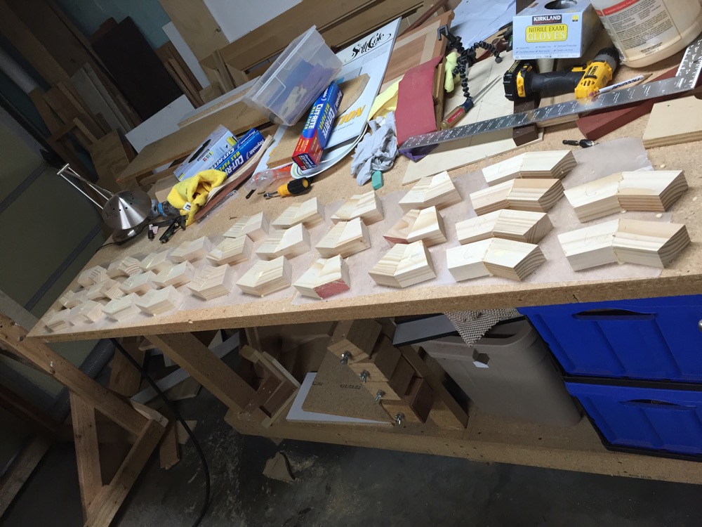

I decided to do a new turning today to keep me busy while working on the codex jewelry armoire. I bought two clear kd 2X4's at HD to start the bowl. This is a precursor to a very large vase the boss wants. If all goes well she wants a vase for dried flowers essential as big as I can make on the SS. As long as this stuff is stable I will use it.

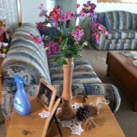

A year or so ago I ran into a simpler way to make a dried flower vase - re-purposing a flubbed pepper mill.
This is very narrow and needed a stand glued to the bottom, but a person could make it a lot wider, if desired.

Here's the vase;

Did the boring work? Not real well. That's why I had to do it over. Using three extensions was just too much, but that mill is 18" long.
In the do over, I drilled from each side which assured both the top and bottom holes would be centered. The hole is offset by maybe 3/16" somewhere around the middle. After a little smoothing with a long rasp assured the pepper seeds(corns)would fall to the bottom with no problem.
The second mill works great. My daughter says they use it every day with both making meals and table dining.
Most of the mills I've made are around 8" tall. drilling is only 6" and was easy.

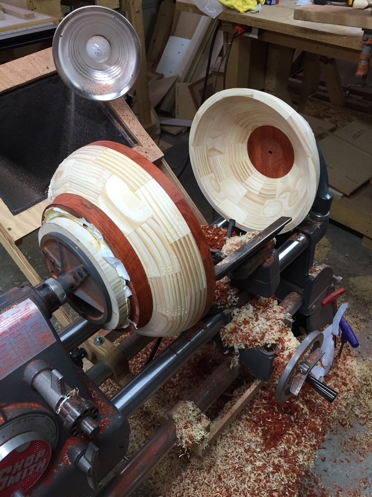

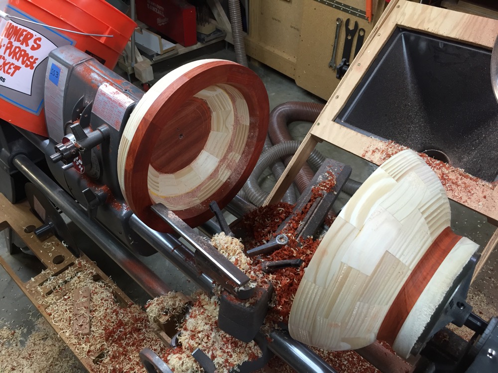

Got home yesterday afternoon and started on the turning. I had glued it all up before I left. Got both halves roughed out.
