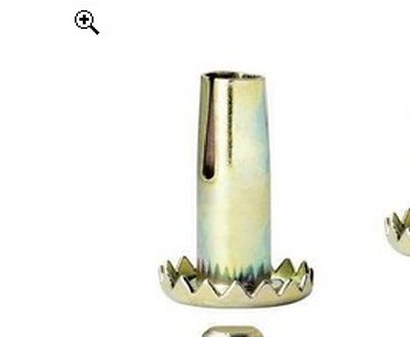

They also make a metal piece that you drive in to predrilled holes and that holds the casters, have not tried it with the shopsmith left overs.

I've made a bunch of SPT dollies with stem casters that come with the socket in Ed's picture and I was concerned the casters would just fall out with no separate socket. But if its working without them, Buckeye, I may give it a try.
Ed, were you able to source the socket separately from the caster?

You guys got me curious about the caster sockets. At this site, you can buy them separately. It shows the split/necked-down sockets being used with a different kind of stem. They call the type on a Shopsmith caster a "grip ring" stem, and as near as I can tell the sockets for those are smooth-bore. The grip-ring sockets they sell are all for shorter stems than on the SS casters.
