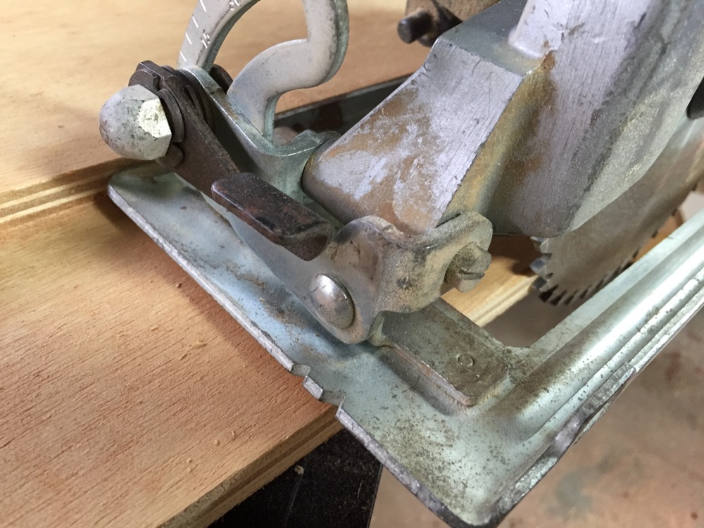

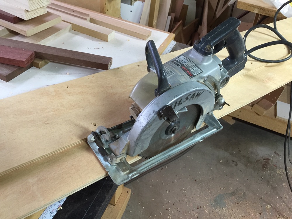

The cut off shoe
Berry asked for an explanation of the cut off shoe. It's a very useful tool for making cuts that are difficult to perform on a table saw. They are essentially a home made track saw but with a back up for the blade which gives you a very clean edge. Years ago I built onsite cabinets using them. You can use them for cutting any angle compound or otherwise. There are a few tips to improve the results. First you need a skil saw that has not been used for framing or any other abusive cutting. The arbor needs to be true. Second you need a good fine tooth finish blade. I use a Freud. This blade needs to be new or newly sharpened and dedicated to use with the shoe. The shoe is made of two sheets of ply glued together. The bottom piece or kerf guide is made wide and then cut to width after the glue dries so it exactly matches and supports the kerf. you can make them any length you need. They are great for trimming doors. Set up is easy because the bottom piece ( kerf guide ) is exactly the edge of the cut. Make your marks, clamp down the shoe and make your cut. The cut will be precisely where at the edge of the kerf guide. You can make one for any angle that the skil saw can cut. For angled cuts you will need a dedicated shoe for each angle. Another tip is to have your finished edge on the bottom and not the top. Especially with veneer. You can use this same technique for routers. Screw a square piece of melamine to the bottom of the router and make a shoe to fit. Using a 45 degree chamfer bit you can produce very crisp angle cuts.
Paul
Paul
- image.jpeg (210.07 KiB) Viewed 6187 times
- image.jpeg (219.04 KiB) Viewed 6187 times

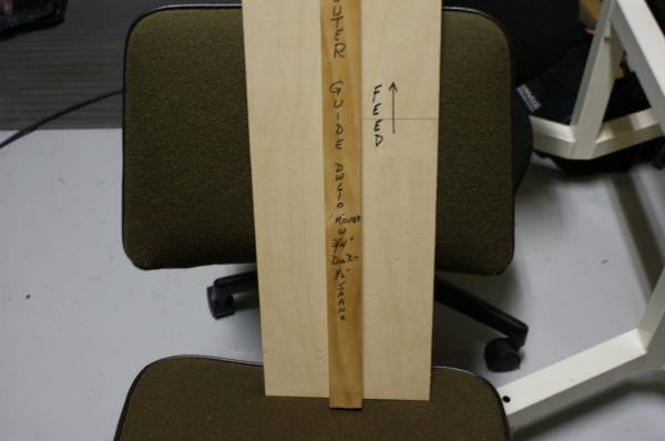

I made a skill saw jigs years ago to cut 4x8 sheets of plywood
I used 1/4" plywood for the base and baseboard molding. glued and nailed together. I have about 6" under hang for the baseboard molding both ends of the plywood. I have one for cutting 4' or less and one for 8'.
They have lasted for years and still are straight.
the over hang helps get the skill saw to start straight.
Re: The cut off shoe
The Skil 77, a great saw BTW, has two holes in the sole plate. I used them to attach a "T" track insert that rides in an 8' "T" track laid in a 3/4" thick piece of BB. Makes a really accurate guide. Bit un handy for cuts less than 4', though.
What a GREAT idea! T-track keeps the saw from tipping and STRAIGHT!!Gene Howe wrote:The Skil 77, a great saw BTW, has two holes in the sole plate. I used them to attach a "T" track insert that rides in an 8' "T" track laid in a 3/4" thick piece of BB. Makes a really accurate guide. Bit un handy for cuts less than 4', though.
