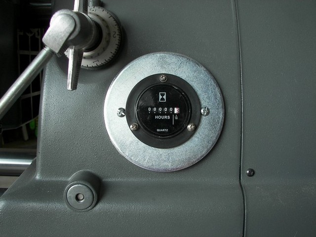

Years ago, I offered an hour meter that replaced the LOGO cover on the Mark V headstock. You removed the black wire to the motor at the ON/OFF switch and connected one wire from the hour meter in its place. You connect the other hour meter wire to the removed motor wire. Then you tucked the hour wires out of the speed control assembly way. I believe I still have a couple of the hour meters laying around. However, I believe that you do not need a hour meter in the Mark V headstock. Once a year, just do a good lubrication in the headstock and check the belt tension and the belt wear as a minimum.
