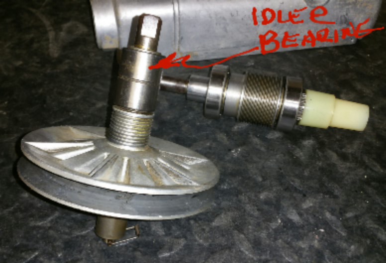

TomHoffman wrote:I'm not sure what you are referring to.
Ha! Sometimes I'm not sure either! I've attached a picture of the idler bearing that I'm assuming you were talking about. Again, I'm hoping someone else responds to what I thought I read about NOT using two separate bearings to replace the original. Am I mistaken?

Thinking this out. I'm betting you're referring to the drive shaft bearing? (There's a 1962 Poly-V drive shaft in the previous picture...same thing, only yours has the gilmer gear). Am I correct?

Yes, I was referring to the right one with the pair of bearings and the nylon cone that the quill fits into. Guess I stepped into it. :o
"Lord. keep your arm around my shoulders and your hand over my mouth."
Re: idler shaft
Both the two bearings on the drive sleeve are replaceable as well as the two bearings on the Mark VII idler shaft.

JPG wrote:Both the two bearings on the drive sleeve are replaceable as well as the two bearings on the Mark VII idler shaft.
JPG, just to clarify, hasn't it been said that replacing the "waterpump" style idler bearing with two separate bearings not as reliable? ...they fail much sooner than the original?
