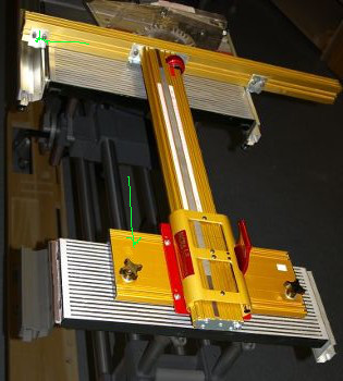

About the only thing the SS version (versus the ones available elsewhere) gives you is the bracket that attaches to the floating table and possibly the wings that ride on the edges of the main table (though I think they come with the non-SS version). Green lines

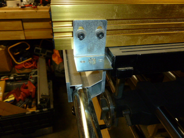

Does anyone have pics of this item attached to SS 510? I have the opportunity to get a LS25 positioning system from a friend and want to know if I can adapt it to my SS.

Sorry this took so long, but I'm not checking the forum regularly.
Also sorry that this is not EXACTLY what you asked for. It is the 520/M7 base rather than a 510, however I believe the main difference would be the rails, not how it attaches nor usability.

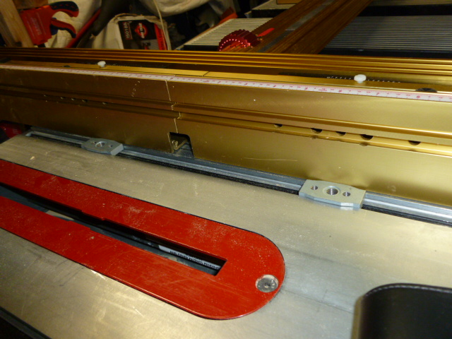

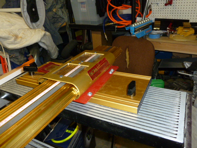

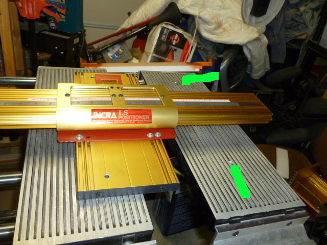

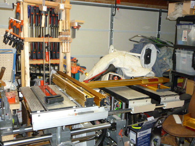

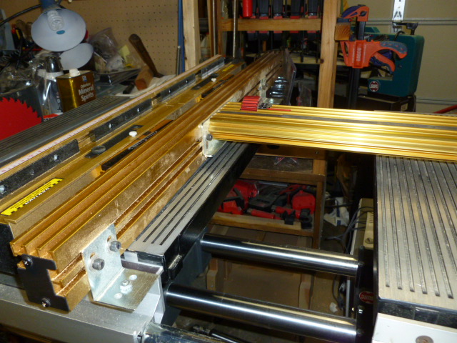

There is the TS-LS mounted (with the Wonder fence, too)
You drill two holes in a floating table, press two nuts in from underneath.
Level up the Aux table with the main, attach the floating table with tubes (I like the 5' ones best, though I did not use them here 0- just a quick setup to show you the system),
Loosely insert two bolts with handles attach the plate to the table
With two sliding T-nuts upside down in the miter slot, press the fence against them to align the fence to the slot.
Tighten the two bolts to hold the plate in place and you are ready to go.
I presume the only difference in the installation between the 510 and 520 is the pieces on each side of the fence that keep it aligned with the table and floating or just touching above the rails
Though its not exactly what you asked for, I hope that helps.
Be well,
Ben

Ben
Thanks for all the pictures and explanations. I really appreciate it. I think I am going to invest in the system since I am about to start to redo all the drawers in our kitchen.
