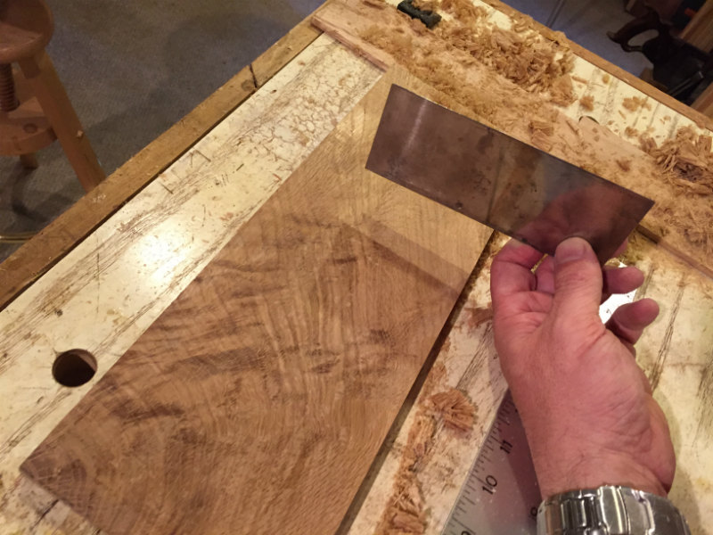

Now as a total amateur woodworker I occasionally find joy in the smallest of tools. This week's edition is my Crown cabinet scrapers.
Nothing like a satisfying scrape over some pieces of hard maple to really bring out the beauty and glassy finish. I am always looking for alternatives for "consumable" tools, such as sand paper.
What really surprised me was the amount of dust resulting compared to sanding. That is some fine dust coming off the wood, not to mention the really delicate shavings that fall apart if you simply look at them weird.
Overall it was a very satisfying (although tires out the forearms) scraping session today.

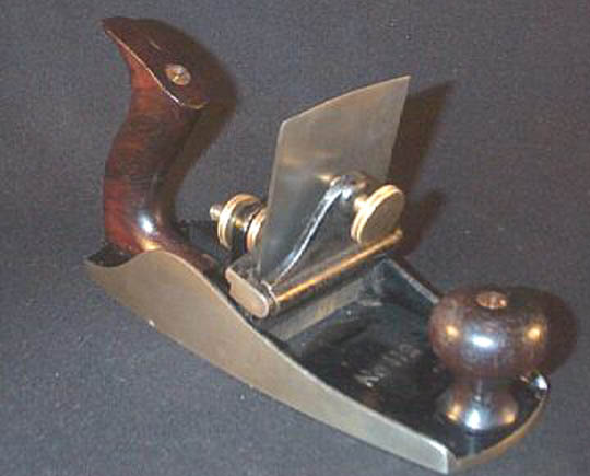

Re: Crown Cabinet Scrapers
I don't use scrapers that much anymore. That was more in my hand tool phase. I do have a set and they do come out from time to time. As I got older I also found it was hard to hold them for any length of time so I invested in one of these:
http://www.leevalley.com/US/wood/page.a ... &cat=1,310
That is a real help for me.
I have the older version of this:
http://www.leevalley.com/US/wood/page.a ... ,310,41070
And that is really nice as well. If I get out in the shop later and if I think of it I get a picture of my version but the function is pretty much the same. If you are looking for consistency this is the way to go.

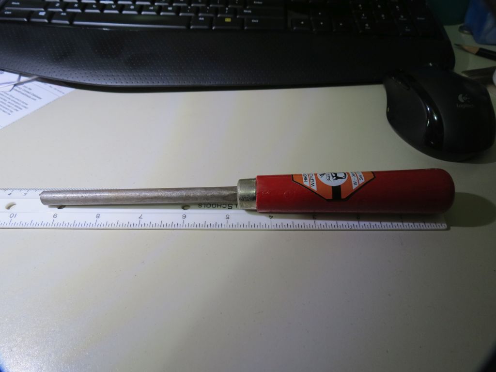

When I first got into using these back in the mid 1970's I got this handy tool which I still keep handy for what ever burnishing needs I have and for curved surface scrapers. It is easy tool to use but you have the control so it lacks consistency unless you can provide it.
I have used a file but only to dress the scraper the burnishing I leave to this tool or the other. It is just to easy to do this way to even think about going to a file.
