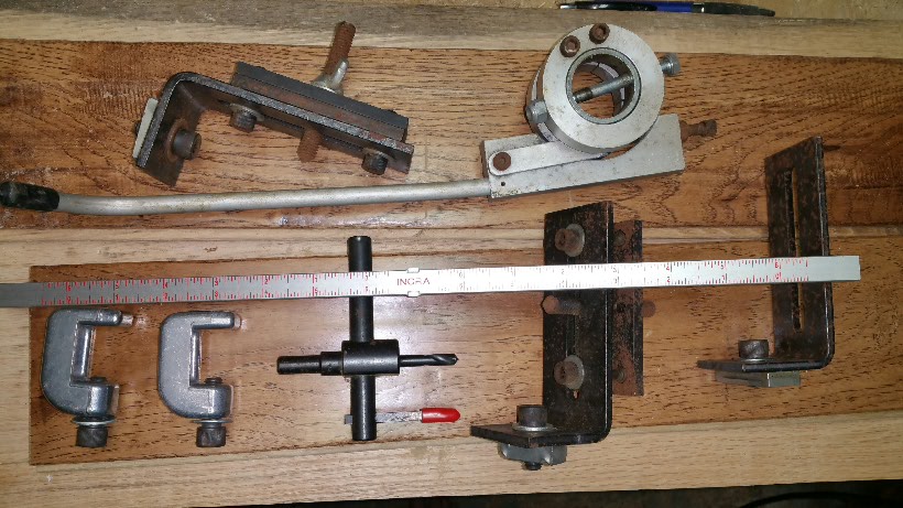

Any idea what the following might be. Or what it might go with?

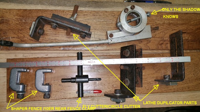

Lower left 2 silver c clips are used to secure the shaper fence on 500 tables.
The drill bit lower middle is a circle cutter for a drill press.
The upper right with a handle and the 3 L shaped black metal pieces... Don't know

Sorry I'm just in one of those moods.......
Also pictured an ink pen, upper right.
Speck of dust, lower left.
Center of picture, Incra rule, due to age and vintage look it might have been from the original jig that shopsmith use to sell.
Then there are three pieces of wood, two of them sitting on a third.

Awesome!
I'll have to assemble everything I've got for the lathe duplicator and take a photo .
I think I've got most of the pieces.
How does the shaper fence attach to a 510 table?
Is there some kind of steady rest for the duplicator

I thought the incra thing was for prying lids off paint cans!
Re: Tool Id help
Incra jig with short section of rule.

Through two holes in the table.richardrouse wrote:Awesome!
The duplicator steady rest is an 'optional'($) accessory.

I thought those clamps only worked with a shaper fence on the 500 table. Goes to show what I get for thinking!JPG wrote:Through two holes in the table.richardrouse wrote:Awesome!

Like many parts, when a need arises, if an existing one will work, it is used.
In this case the shaper fence clamps were initially the rear camp for the 10ER rip fence(used a different knurled screw). Likely because the fence was also used on the 10ER(????)
P.S. Realize there are three different shaper fence versions. for different table designs.
