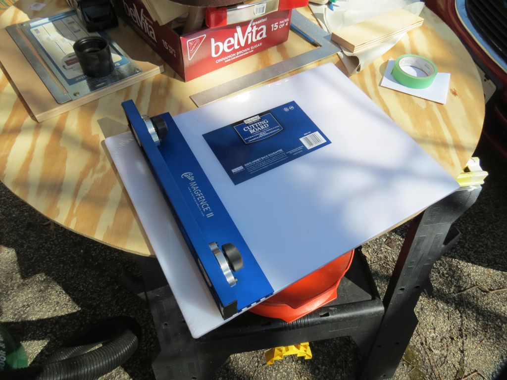

I have a shopsmith bandsaw with cast iron top and an older other bandsaw also with cast iron top. I've been looking at getting a fence for them and made my decision to go with the Carter Mag Fence II. (Once I get some time with it I will review it here.)
It is about 3" tall so depending on what you are cutting that is plenty high or not high enough. So while this has been a slow process I did acquire the fence for a decent price and did a preliminary checking out of how it it works. I'm impressed enough to go to the phase of making some fence extensions. Carter does sell them but I figured I'd make my own since it seems like a pretty simple thing to do.
I buy these cutting boards at Sam's Club for less then $10 and I have purchased a few of them and used them for any number of different things. I normally have at least one spare one laying around for a quick thing to grab and use. In this case it seems like a pretty good way to go. First is the size, the width of the fence and the width of the cutting board are a match.

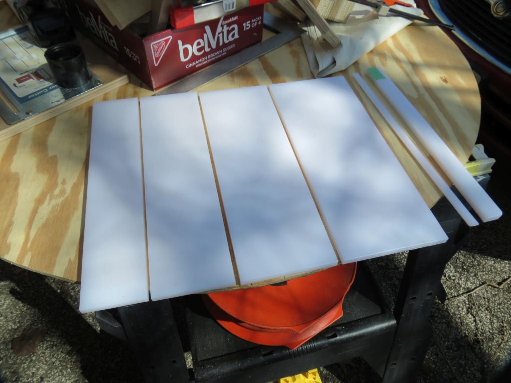

From that I trimmed off the rounded edge and then cut a fence 3" tall, 4" tall, 5" tall and a 6" tall one.

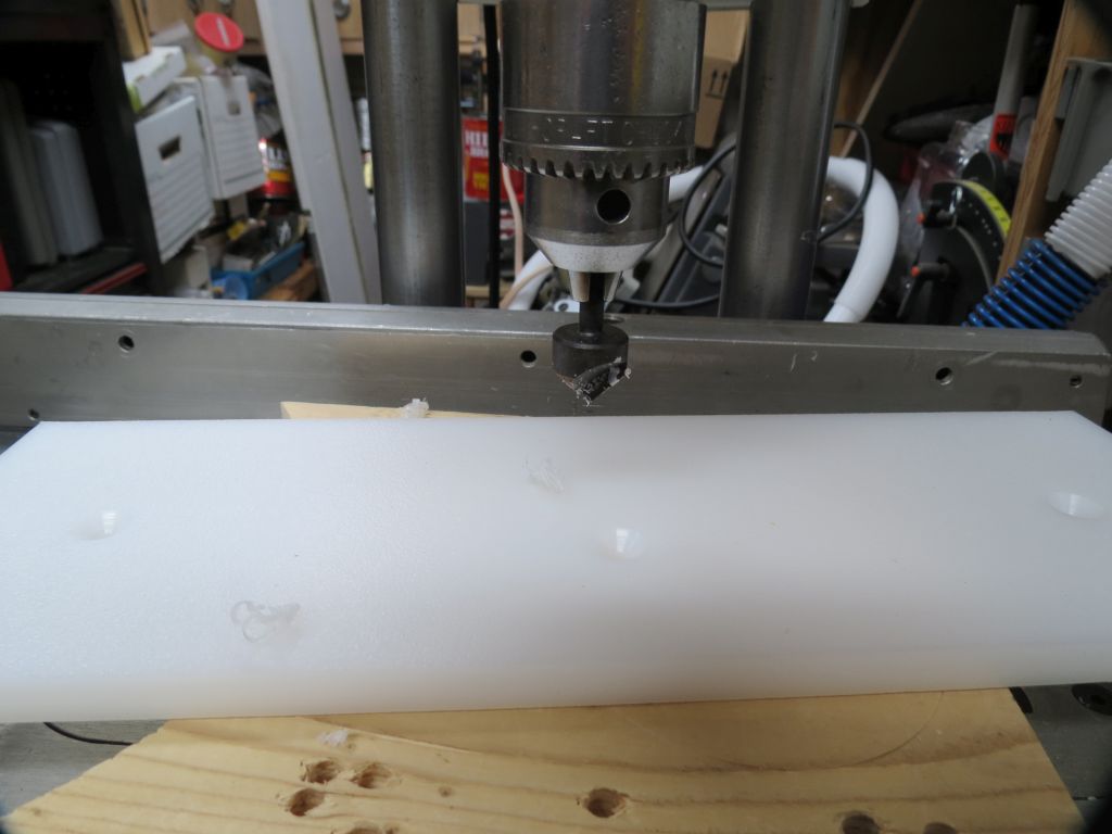

I then drill them so I could mount them using a 1/4"-20 nut in the t-track. There is another post about the drilling but you can make something like this and do how you see fit to mount things.
I was going along pretty quickly but needed some fasteners which turned up only 3 of the screws I wanted, I had planned on have a set of 3 for each of the extensions but for now that is not happening. When I got home and went to put the screws in a second surprise showed up. The heads were slightly larger then the sample I had used to do the countersinking........ yea that can happen. So I had to do a quick touch up on all the holes so the heads were below the surface. Ah the plans that go bye bye in the blink of an eye.

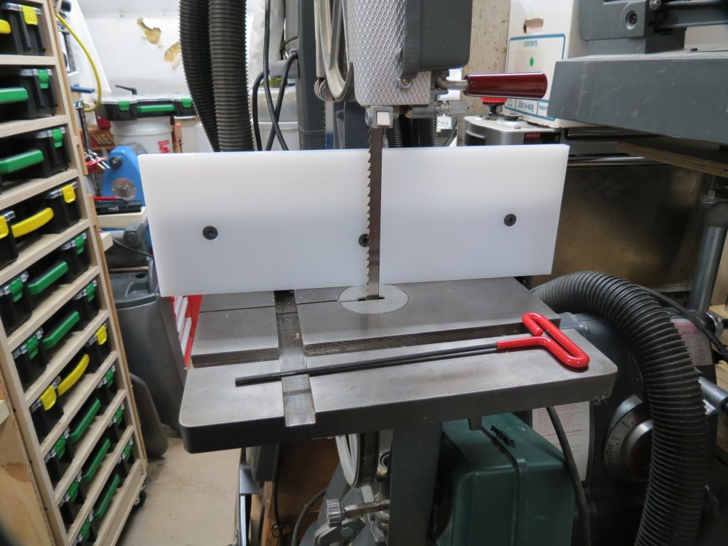

Anyway they are all done and ready for testing when I get to that point.
Shown is the 4" tall version, or was it the 5" version, I forget, anyway it is what it is.

Hi Ed,
two things
First, you might want to consider a small chamfer along the bottom edge since the bottom looks flush to the table. That saw dust build up along the bottom can be just enough to piss a guy off when he least expects it. :mad: . Now I design my rub fences to set a couple playing cards thickness above any table surface.

There is slop in the track to screw fit so if I need some extra space on the bottom I believe I can get it by changing how it is mounted. If not I can fine tune it later, the plastic is easy to work with and a hand plane could be used to make adjustments or a chamfer. I used nominal dimensions as a starting point.
For resawing in general on the band saw the major part of the dust is taken with the blade down into the saw, so I wasn't treating it as a concern, I guess time will tell how true that is.
I've been using a single point fence for resawing and while I have played a little bit with the miter fence as way of doing this I wanted to play with this sort of fence for a while now. The single point fence pretty much is eye balling the cut as you go which has always worked but it seems you miss out on all the fun of trying to get a fence aligned to the blade that way.
