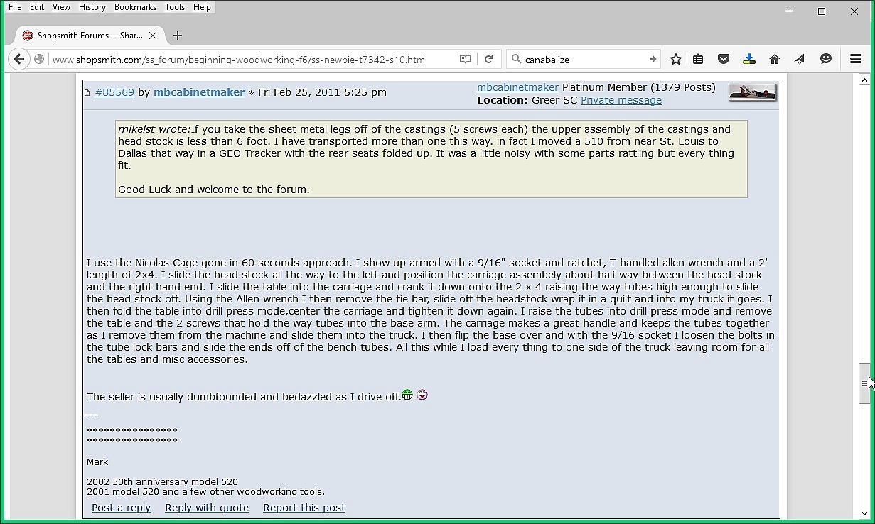

Why not just remove the aprons/legs at each end, just 5 bolts at each end. Or do you need to take the support tubes also?
I cant picture in my mind the rod you are speaking of but will a link here.
http://www.shopsmith.com/ss_forum/viewt ... #post41339
Re: Breaking down a Mark V for transport?
TRANSPORTING SS.jpg (413.44 KiB) Viewed 3460 times
The slickest that I know of!
FWIW, that 'hollow' tension pin can be driven THROUGH since there is a hole behind for the pin to exit.
P.S. use a pin punch so as to not cause the tension pin to 'open up' as it is driven.
