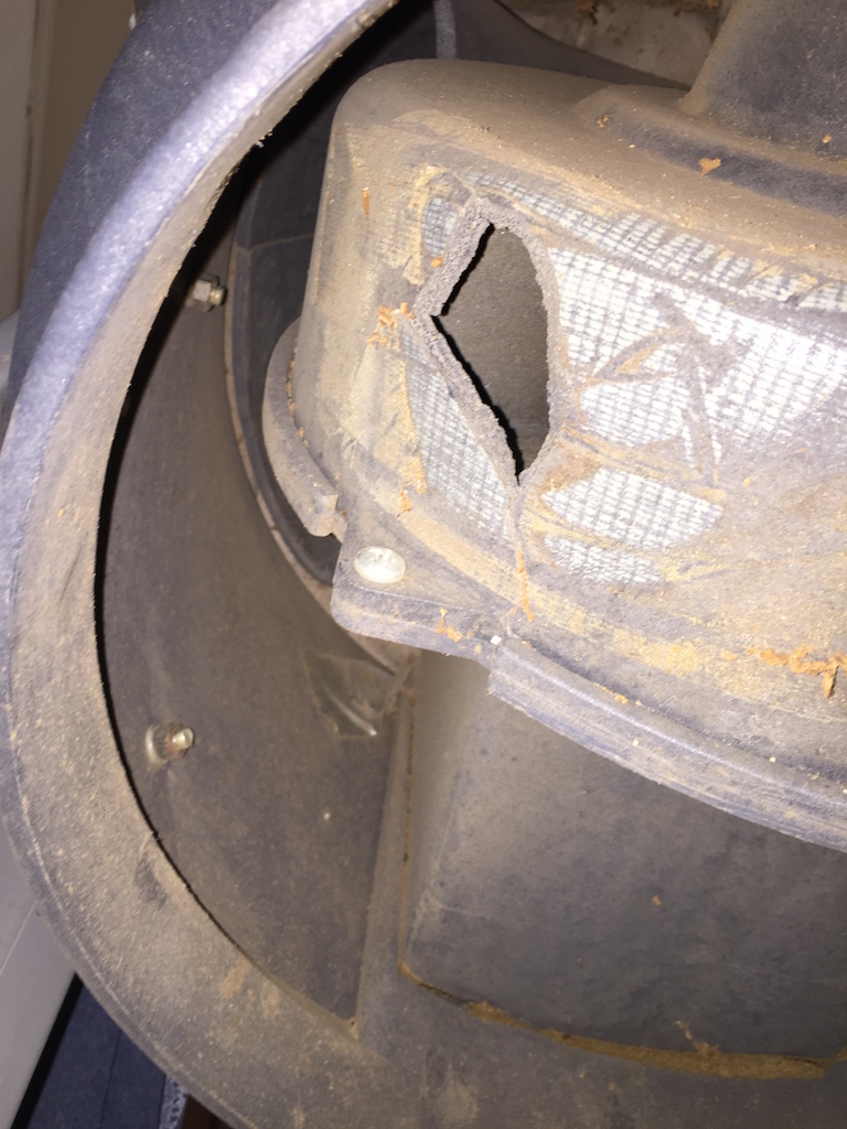

2) Dust Collector was included, but fan housing was damaged and duct taped. Any suggestions on repairing with fiberglass?

2) We like pix. A pix of the taped housing will help to better understand it.

Thanks for the reply - JPG!
On island of Oahu, windward side.
Photo of damage to Dust Control fan housing.
Appears to me the damage was external source, have not powered on as there are no waste bags.

If the dust collector were mine I would look at the impeller to see if there is more damage. According to SS the impeller is one of the 17 most requested repair parts. The hole indicates to me that something was picked by the system and forced between the impeller and the side of the housing. A broken impeller will create an imbalance and maybe a severe shake. So be careful when you turn it on. Move it to an outdoor area and try it without a bag. That material is some really tough stuff. Must have taken a LOT of force to break it.

Good advice Bill - should be easy to disassemble. Nice of ShopSmith to make the manuals available online, and on paper.
Re: Aloha! - used SS 510 - 2 questions...
That duct tape was used and apparently successfully implies the impeller is ok. Need to verify that.
Regardless some jb-weld may fix the missing chunk(I assume it is 'missing').

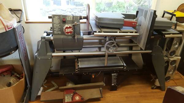

Nothing rattling around and the missing piece wasn't in the box overlooked when I picked up the machine. Picked that box up this morning and got arbors, saw blades, table saw miter, and unused lathe components and tools. Still missing the drill chuck and manuals but I'm very pleased with my new tool, going to be fun!
Craiglist photo:
Listing Photo.JPG (40.49 KiB) Viewed 4414 times
Good looking machines.
Keakap where art thou? A fellow islander could use your help!
