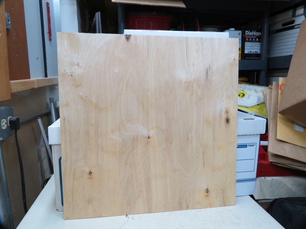

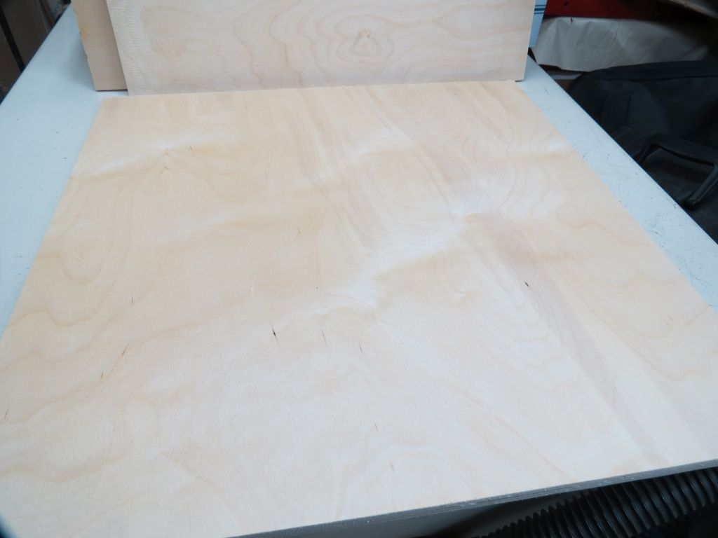

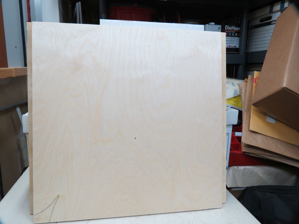

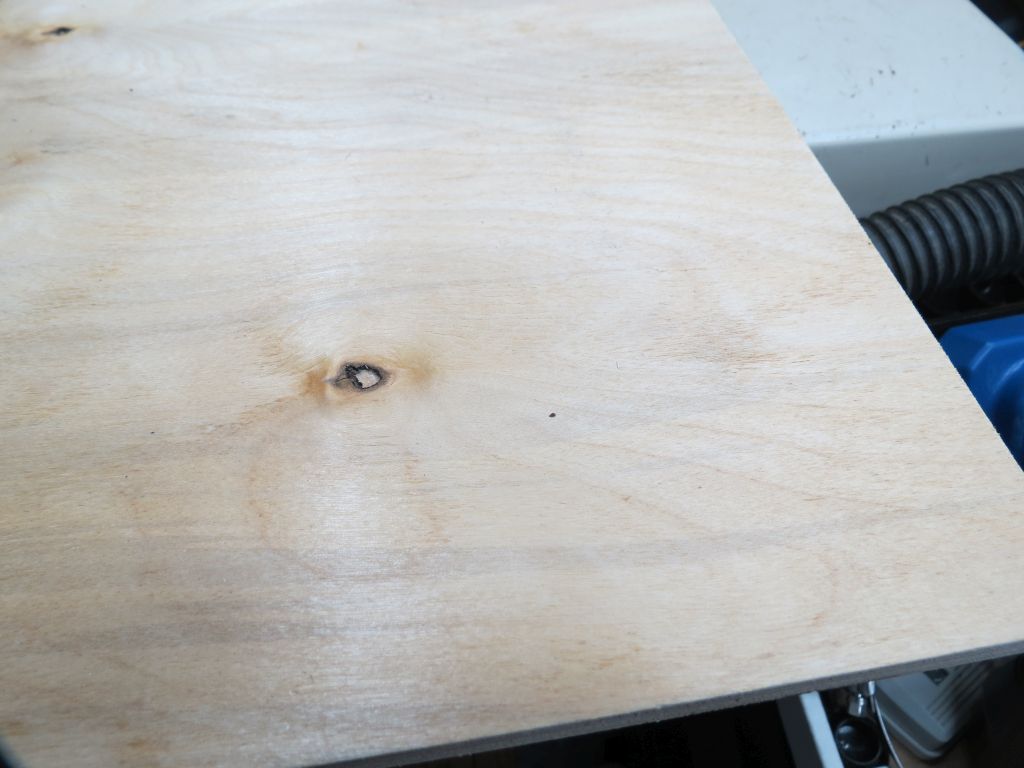

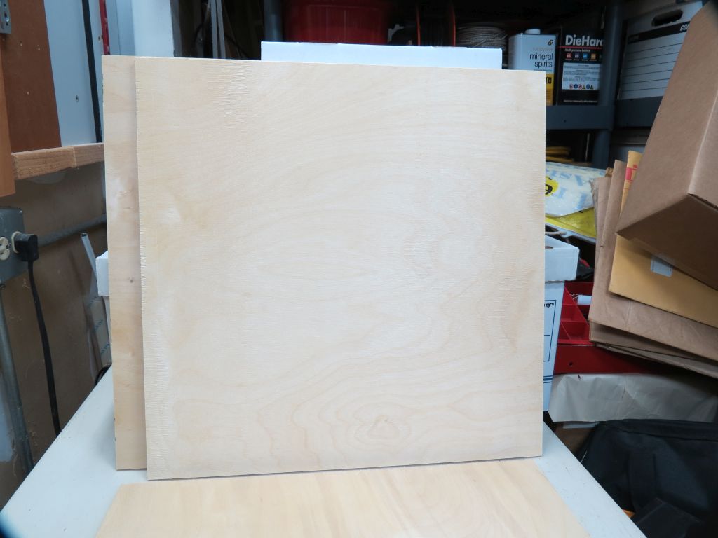

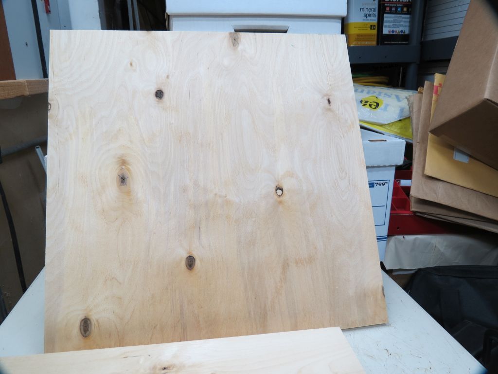

So here is what I have found so far. This has 9 layers which all seem uniform as in no thin veneers on the surface. Out of the 5 pieces that I took off the pile (I did not sort them for size or quality, just first come first taken). One piece had open knots on both faces. One had a open knot on one face, three had no open knots on either side. Examining the sides, 4 on each of the 5 pieces there were no open voids visible.
I used a bathroom scale to weigh the 5 pieces and that totaled 22 pounds. 20" x 20" = 400 square inches per piece times the 5 piece for a total of 2000 square inches. Converting that to square feet that is 13.888 square feet. Weight per square foot is then 1.58 pounds. I have to reference that to some other materials but it feels heavy to me.
At the $1.99 price and that would be a total of 5 times that or $9.95 for 13.888 square feet or $.71 a square foot.
I have a few picture to share so you can see the surface quality or lack of it.
So that is about it for tonight.

Same avaliable at my Menards I sorted the pile and ended up with 10 pieces with no knots (one had a quarter, 25 cent piece size, tight knot and 1 had 2 dime size knots, on 1 side each, just to clarify) I bought them to make storage cabinet drawers boxes, ( 4"high sides) using a drawer lock bit for joints. The Russian Birch plywood machined well, clamped and glued up very well. Note: 2 - 4" X 20" pieces De-laminated right up the middle, looked like there was little or no glue on those ply's. Other wise very happy with results and cheaper than sanded birch plywood which was my first choice.

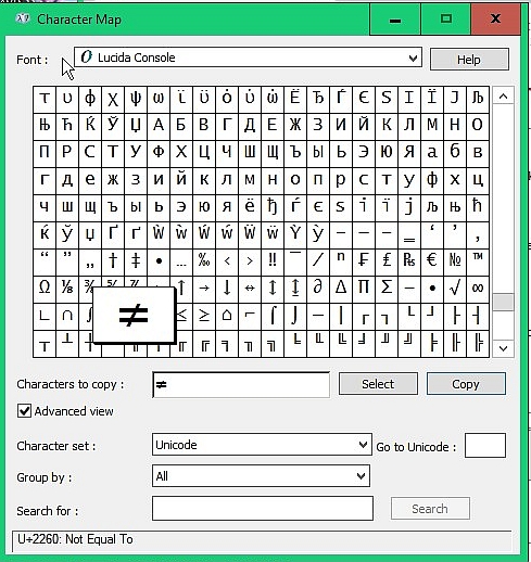

JPG how do I get the "not equal symbol" in windows?
Re: Russian Birch Panels at Menard's
This'n? ≠jsburger wrote:This is not Baltic Birch ply as I am sure you know or as I know it. Baltic Birch has 13 plys for 3/4". There are fir plys that have 7 plys but most have 5.reible wrote:So here is what I have found so far. This has 9 layers which all seem uniform as in no thin veneers on the surface. Out of the 5 pieces that I took off the pile (I did not sort them for size or quality, just first come first taken). One piece had open knots on both faces. One had a open knot on one face, three had no open knots on either side. Examining the sides, 4 on each of the 5 pieces there were no open voids visible.

I know what the symbol is. How do you type on a keybord?JPG wrote:This'n? ≠jsburger wrote:This is not Baltic Birch ply as I am sure you know or as I know it. Baltic Birch has 13 plys for 3/4". There are fir plys that have 7 plys but most have 5.reible wrote:So here is what I have found so far. This has 9 layers which all seem uniform as in no thin veneers on the surface. Out of the 5 pieces that I took off the pile (I did not sort them for size or quality, just first come first taken). One piece had open knots on both faces. One had a open knot on one face, three had no open knots on either side. Examining the sides, 4 on each of the 5 pieces there were no open voids visible.

JSB there should be a screen shot of the character table above 'not equal.jpg'. It is appearing on my post, but not yours??????
