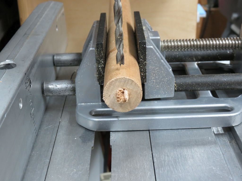

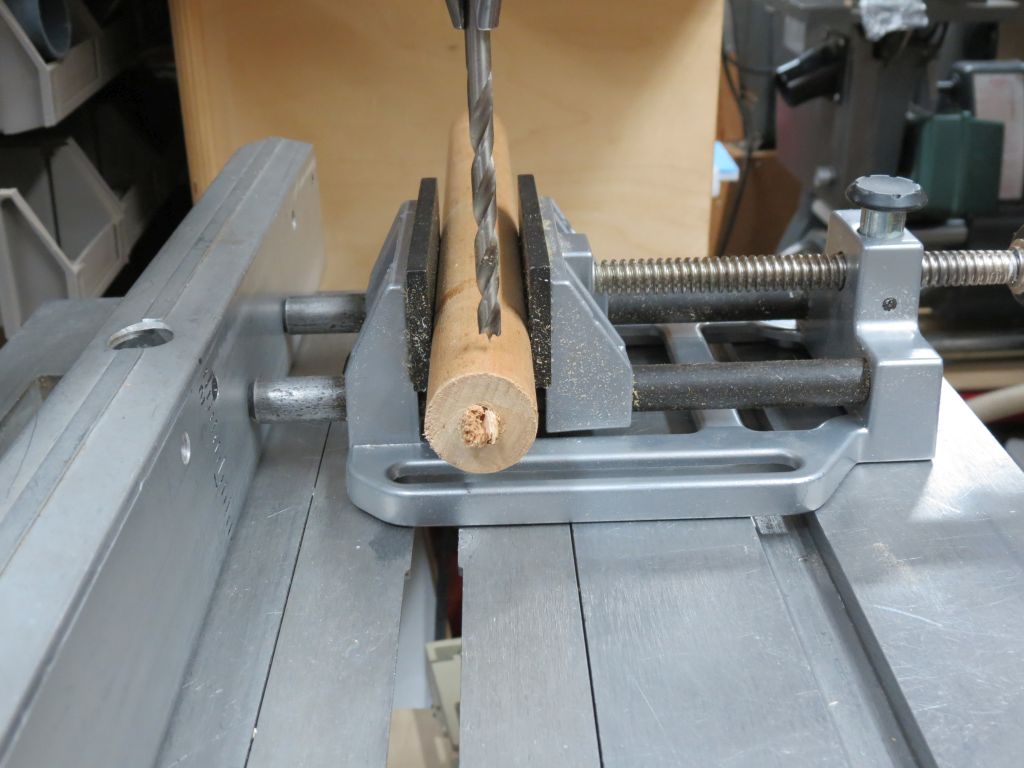

First we have the old way, visual location so to speak.
In this case it isn't lined up very well so you move it just a bit this way or that way and look again.
That is pretty promising, in real life anyway but the picture makes it look father off then it is.

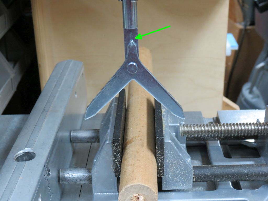

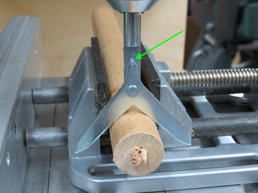

Well now comes the tool, mount it in the chuck and watch the pointer and the line as you lower the arms over the dowel.
Hard to see here but it wasn't line up perfectly so I would have to tweak it slightly until it did line up and then I could go back to the drill bit and drill the hole. Note the fence is now locked so any hole drilled in this dowel is centered.
So this is how it should work and as you can see it is a pretty simple tool.
