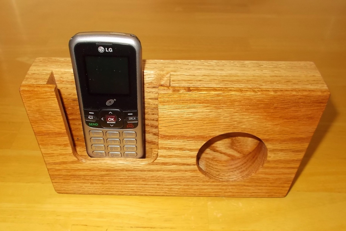

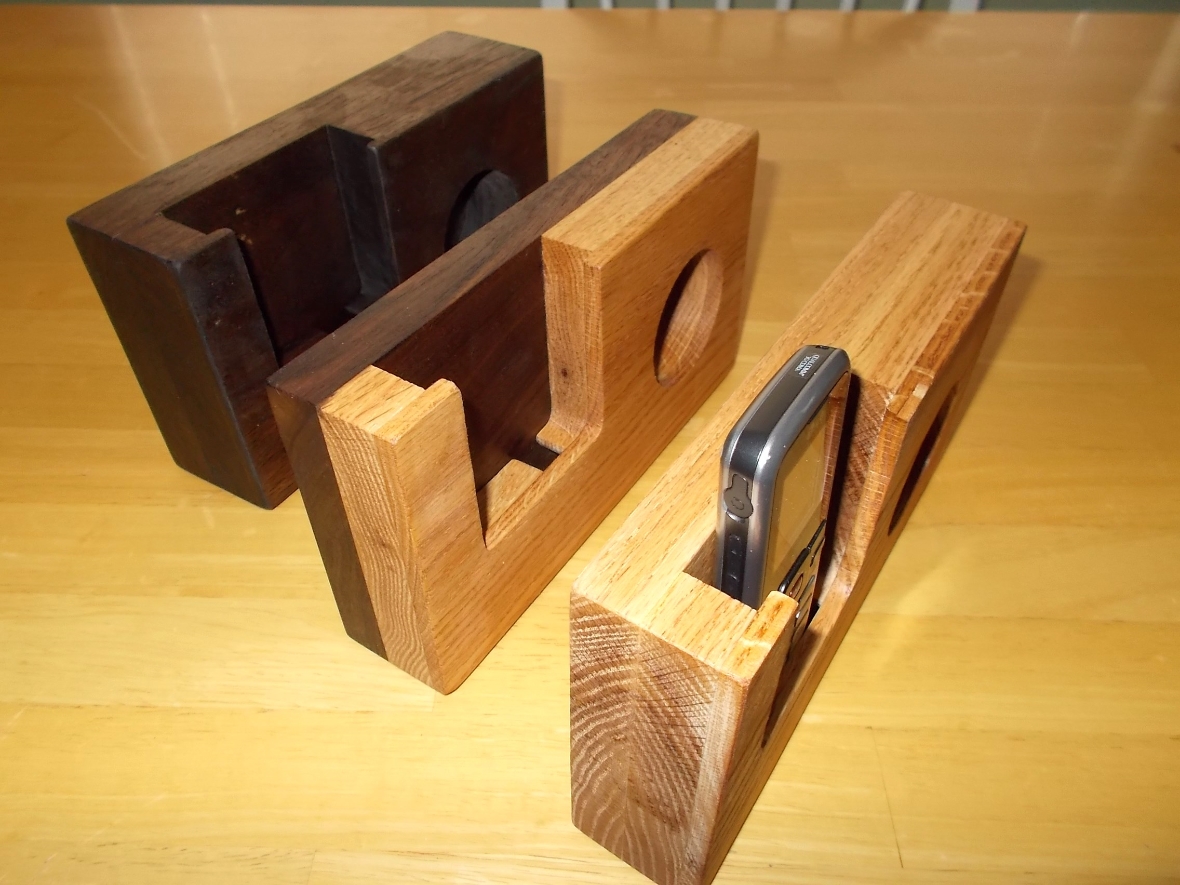

The photos below are of wooden, passive amplifier that I have scaled up to fit an I Phone 6. The original plans are from Steve Good's website and was for an I Phone 5. These 3 amplifiers are gifts for family & friends.
Please note the phone, in the photos, is my antique, cell phone. It is only in the photo as a display.

How big is the hole in the front?

The hole in the front 2 1/8". This is the largest Forestner bit I have.
I probably should also mention that I glued cork feet to the bottom of each unit. My brother-in-law recently put new windows in his house. So, the 1/2" square cork spacers, used in the packing of these windows, was perfect.

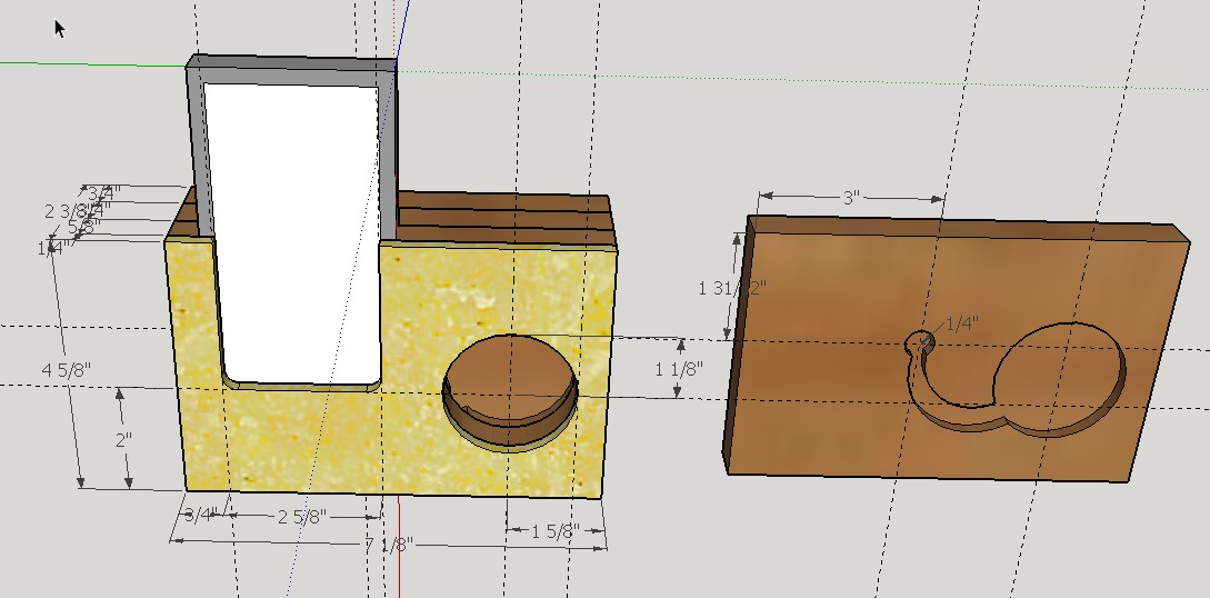

So I wonder how critical this stuff is? I did a design to fit my phone and think I'll give it a try. I guess someone must have optimized these but with so many designs out there it pretty hard to tell a good design from a bad design.
This is the ruff design subject to some tweaks.
ScreenHunter_120 Mar. 14 17.12.jpg (86.58 KiB) Viewed 12922 times
I guess after I build mine I'll know how I did.

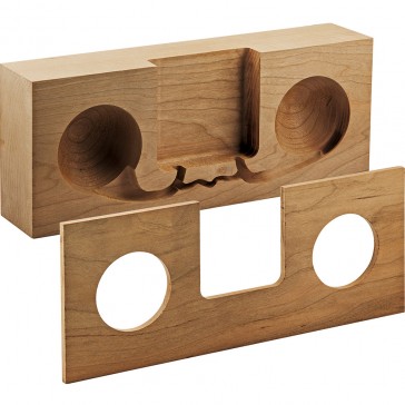

I like your design, Ed. Also wonder how something like this would work. I've had this photo in my computer for the last year, but haven't gotten a round tuit. It reminded me of the folded horn speaker enclosure, I built years ago.
I-PHONE SLOTS.jpg (27.37 KiB) Viewed 12890 times
The important parts of this design are the widened slots toward the "speakers" and the rounded back of the speaker hole.

I wonder how they create the shape of the "speaker" in your photo, perhaps a cnc machine? I guess if have to have that I would make the back in two pieces one being a square that I could put on the lathe. Then turn the shape as best I could and glue it back together and do the passage ways. Do you have any ideas?
