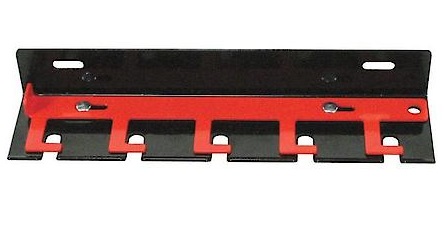

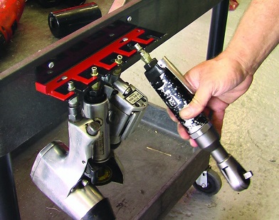

Welding Web had this one http://weldingweb.com/showthread.php?16 ... -tool-rack
Garage Journal had (see 14) http://www.garagejournal.com/forum/show ... hp?t=13647 though (2) is interesting
Lisle locking air tool holder, No. 49960 is about $30 at Advanced Auto Parts but $16.97 at Summit Racing

If you have a welder, You can purchase "Steel" female quick connect couplers and weld them to a thin strip of steel which you can then attach to any wood structure or framing.
If you don't have a welder, You can purchase the "Male" quick connects and using a 1/4" pipe thread tap, Thread some thin steel and thread the couplers to the strip. If you go this route, Make sure to plug off the hole on the coupler after threading into the steel strip.
JMO, I wouldn't use the commercially built holders which have your air tool hanging in the position where dust and contaminates can fall into the nipple. The dust which will fall into the nipple can possibly cause a lot of damage to the vanes of the air motors.
Just as if you store an air pump gun with the barrel facing up and dust falls down the barrel and into the chamber and screws up the seals...

Thank you but those are not the one I saw. The one on post 14 of the garagejournal is something like what I saw but different, you know the same principal....
Anyway it was fun looking at those ideas too. At $2.99 each at harbor freight I just do a few to see how I like it before investing too much cash.

I don't like the idea of the open hole either. The one I saw they were hanging upside down under a board/shelf but I'm unsure how they attached them the couplers I mean.
I'm sure I have a tap of the size you mentioned so I could just get some bar stock and drill and tap it for a strip which I could then attach below a shelf/cabinet.

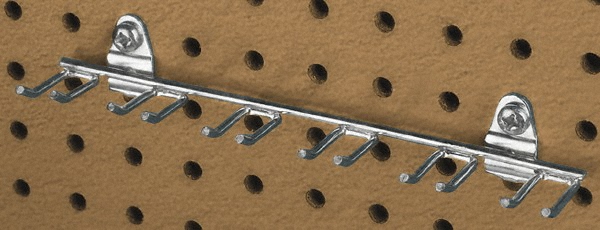

I use a pegboard something? holder which is a row of double prongs (thought it was screwdrivers but it wasn't - found this on picture of what I use). Then I just attached a shop cloth to the top which I drape over the open ends. Having the holes up makes it easy to put in a few drops of oil.
Here is a picture of similar to what I use. I had to bend the prongs closer to hold the groove in the nipple.
