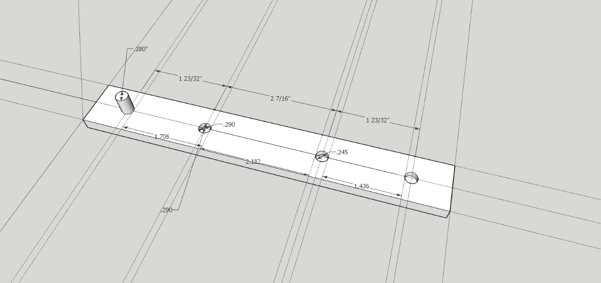

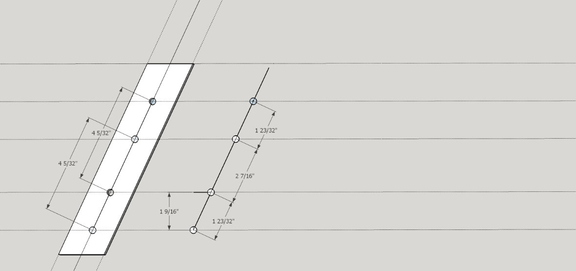

Here is the template that I used.
This is a template created by using data provided by another of the forum members.
- Caster Template by Algale.png (106.3 KiB) Viewed 9961 times

When you buy the casters they include a template. I have not seen a down load for it.
I think you would have to ask shopsmith if they are willing to send you one.
They do offer a drilling guide with bit for like $18 if you would rather have that.
If you have more then one machine to do then the template might make more sense. Or using one the drawings Dusty presented and make your own.
Now it is also possible shopsmith has newer placement then they did when these drawings were made so if you want the latest and greatest from shopsmith that would/could be different now. Again a call might make that apparent.
