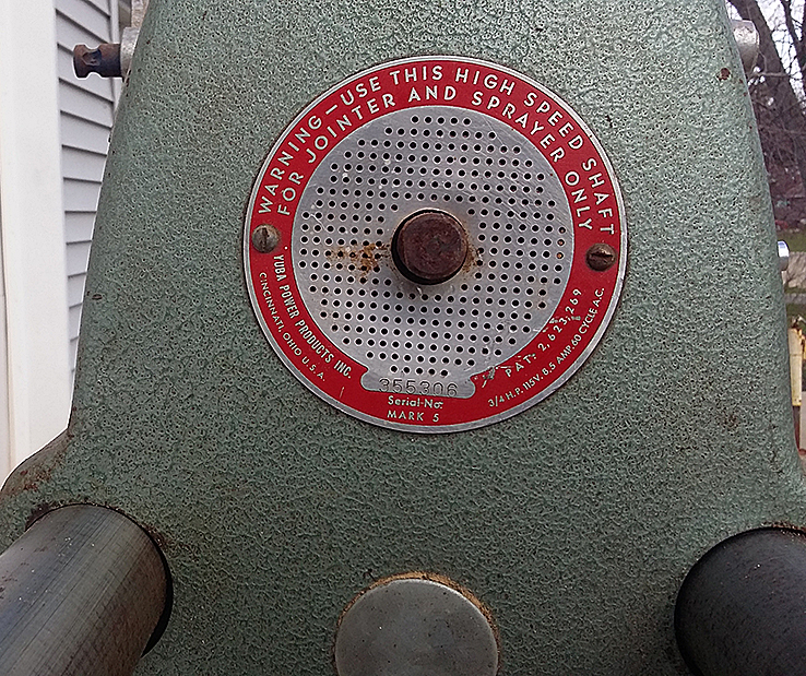

I purchased a Yuba Power Products Mark 5, 1957 according to the Serial #, she is a bit rough, but I believe I can make her shine.
Please jump in and tell me if I can't do this, because parts won't swap.
My plan is to take the guts, motor, drive system and double Bearing Quill out of my 1981 Mark 5, when I update my 81 to the new power pro upgrade, when it arrives, and install them in the headstock on this Greenie. I had planned to go with the original colors, but am leaning heavily to a Satin Dark Gray.
Any way here are the picture shortly after she arrived at her new home.
Your thoughts?
P.S. I paid $80.00, and I know where the Jointer and Belt Sander that actually came with this unit are and the guy that has them said he would give them to me if I bought this SS.

So everything will swap, I can use my 81 parts to upgrade this 57?

$80 plus the jointer and bandsaw thrown in for free?! Helluva deal! Your pictures remind me of when I brought my '56 home almost a year ago. Can't wait to watch the restoration!

Almost. It is likely a Gilmer drive. A complete set of poly-v parts will fit/work.jjbuzard wrote:So everything will swap, I can use my 81 parts to upgrade this 57?JPG wrote:

Almost. It is likely a Gilmer drive. A complete set of poly-v parts will fit/work.[/quote]jjbuzard wrote:

And because I updated the 81 with a 2 bearing quill and poly v belts, that solves that problem.JPG wrote:Almost. It is likely a Gilmer drive. A complete set of poly-v parts will fit/work.jjbuzard wrote:So everything will swap, I can use my 81 parts to upgrade this 57?JPG wrote:
