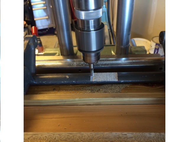

After being inspired by some of the threads that I saw with a router mounted to an extra table, I am nearing the end of my own version. All of the aluminum that required removal was all milled using my SS. The table still needs to be cleaned up, I'd like to mount a separate switch (maybe a paddle), throw some paint on it, and figure out what I want to do for a fence with a dust collection port.

Thank you. I wanted to make sure that I was able to get the full height out of my router and even though the Greenie table is a little small, I think it will work just fine. I think I am going to stop at the Dollar Store and pick up a couple of cutting boards so I can make the throat plates. I am also trying to decide how I want to design the fence so I have dust collection capabilities as well. While I was pondering the whole fence design yesterday I looked at my shaper fence and I think I will incorporate it into the design. More to come...everettdavis wrote:I had not considered doing that. Nice solution.

What bit did you use for the milling?

Appears to be an end mill.JonE wrote:GM

Like JPG said, it was an end mill; now I am looking for a ball end mill so I can curve the edges to prevent cracking.JonE wrote:GM
