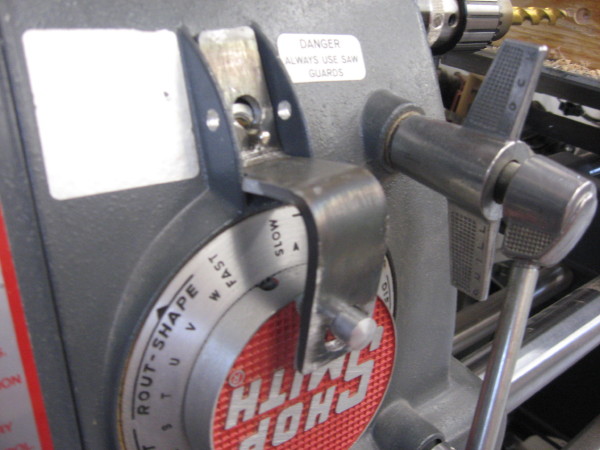

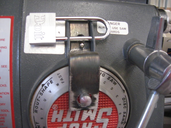

made a plate to lock switch and maybe more important the speed control dial.
like it says prototype the hole for the switch is not perfect but, the padlock still stops the switch....

There is a design for one of those that I have been looking for of late. I don't recall if it was in one of the shopsmith publications or books but I know it is somewhere.
It certainly looks like your idea will work, might heavy on the iron works but what you had on hand I would guess. Even sheet metal would work.

Excellent idea! Thanks for sharing it with us!!! Stops unintentional start up while protecting the speed control from the curious or uneducated operator...

Reible: I used what I had. 3/16 x 1 1/4 flat plate .
should be 1 inch wide then it would fit without grinding.
3/16 thick would still be my choice. anything thinner
would be able to be bent up or cut with a shears.
kids and relatives are sometimes quite innovative..

Ed, I recall reading about that speed dial lock many years ago in the old "Hands On" magazine...
My design change would be to use a circular disk as the lower part of the lock with a ring of holes about like the old phone dials. Then there should always be a hole close enough to lock it without having to turn it on to move the dial to line it up. There is always enough slack in the dial to move it a tiny bit without having it running to get in position to lock it. I would find having to flip it on to move the dial to be one of those nuisances that would keep me from bothering to lock it. My woodshop is in the basement and there is no kid access to it. Adults can be a problem at times though.
A second mounting point at the bottom of the dial might be helpful.
I'm also putting an extra SS in the farm shop for some more carpentry type work and it will be more exposed to the adult problem and in even more need of locking.
I am more concerned about the speed dial damage than the tool getting turned on but a lock-out could be a good idea too.
