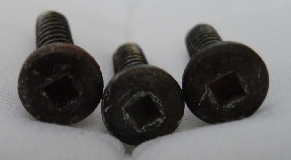

Yesterday my self-propelled lawn mower stopped propelling. I shut it off, turned it on its side and the belt was okay but would not turn and the pulley from the motor was okay. I had to take off the plastic cover over the belt on the deck only to discover these screws holding down the cover on the pulley. I have something to remove about every screwy screw but not these square ones. The top of the screws is rounded so you can't get it out with vice grips. Had to grind down an Allen wrench to the right size. A small stick was jammed between the pulley belt. The belt was okay but 4 years old so I decided to replace it and got one at HD for $15.

I dont know, #2 square drive bit is pretty commonly used. In most bit/driver kits you get a couple of them just a #2 Phillips.

FWIW, square drive screws are quite common now. It didn't always used to be that way. The first ones I remember seeing was when I was stationed in Canada in 1980-84. If they existed in the US back then they certainly were not common but that was about all you could get in Canada then. Almost all the wood screws McFeely's sells today are square drive. I buy from them in bulk so most of the wood screws in my shop are square drive. The bits and drivers are easy to find but McFeely's gives you free drivers and bits with some of their assortments. They are great. It is almost impossible to strip the head or have the bit pop out of the head.

An effort to combat the problems associated with corrosion which usually condemns standard hardware to the point it's impossible to remove.
Re: I know why they do this
Funny, but frustrating things is often how we find out about square drive screws and screwdrivers. About $8 or so will get you a #2 square screwdriver or a set of assorted square bits.

Same as John. However, the screws that I purchase from McFeely's drive wonderfully. They hold well and will really pull two parts together.

I have been using stainless steel square drive screws on fences for quite some time. They hold up, and are easy to remove. I just did so for pickets a the post junctions with two fence sections to get a new 10 x 20 barn installed, and they came out very easily. I recommend the square drive, and stainless steel.
They really take more torque than a #2 Phillips and most often are used in areas where stripping them out means a drill and an EZ-Out in machines.
I am sorry you had the problem, but I would also encourage you to get quality square drive tips for your 1/4" magnetic tip holder for ease of use and durability.

They are called Roberts square drive bits. Cheap adapters can be had anywhere
