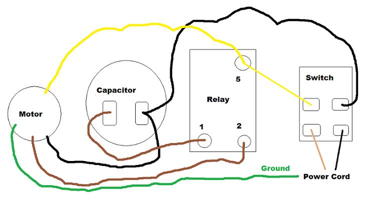

I will assume you have a "GE" 3/4 hp motor.
The wire colors are suspect however.
The sketch below is typical.
- GE_75HP_WiringDiagram.JPG (31.84 KiB) Viewed 3595 times

I agree, I do believe I have a 3/4 HP GE motor based on other pictures I have found here.
However, the colors do not match at all. I only have 3 coming out and they are as described above: Red, Green and Yellow. I don't have a black or a brown.
To add to the confusion, the power cord is only 2 prong. Only hot and neutral. Does not have ground. Hence, no wire to go from power cord to motor. (I will look into adding it once the rest of the wiring is done.)

@ Ezjamm> To add to the confusion, the power cord is only 2 prong. Only hot and neutral. Does not have ground. Hence, no wire to go from power cord to motor. (I will look into adding it once the rest of the wiring is done.)
Thats the way they came, 2 pronger, and I replace the cord on my greenie, and no ground internally as JPG drew up, he must have been thinking later models that do.

I found a post that may work for me as far as wiring.
http://www.shopsmith.com/ss_forum/viewtopic.php?t=3227
As far as the actual picture colors, they match what I have. As far as the diagram, they do not. (Unless I'm going color blind or am seeing a golden dress when in reality it is blue.
At any rate, I'm going to wire it as per pictures and cross my fingers. Thanx to all who helped out.
One last question though, does this motor have a thermal cut-off switch. I'm guessing it does not.
