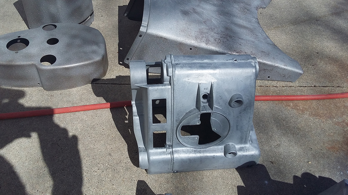

As promised here are the pictures of the parts, especially the Aluminum parts after being blasted with Soda Blast, the parts are almost smooth, unlike blasting with Black Blast, which leaves the surface with a textured finish. You can see all of the original grinding marks that resulted in smoothing the casting marks and the color swirl from the casting process, Soda doesn't obliterate these surface marks.
It took almost a whole 50 pound bag to shoot all of these parts, half a bag of Black Blast to clean up the rusted steel parts.
You can see how smooth the aluminum is after soda blasting, which is more like cleaning than blasting.
Headstock 2.jpg (699.73 KiB) Viewed 3634 times
Here you can see where the worker ground off the casting flaw above the on off switch, sand blasting would have covered this up
Headstockgrind mark.jpg (719.85 KiB) Viewed 3634 times

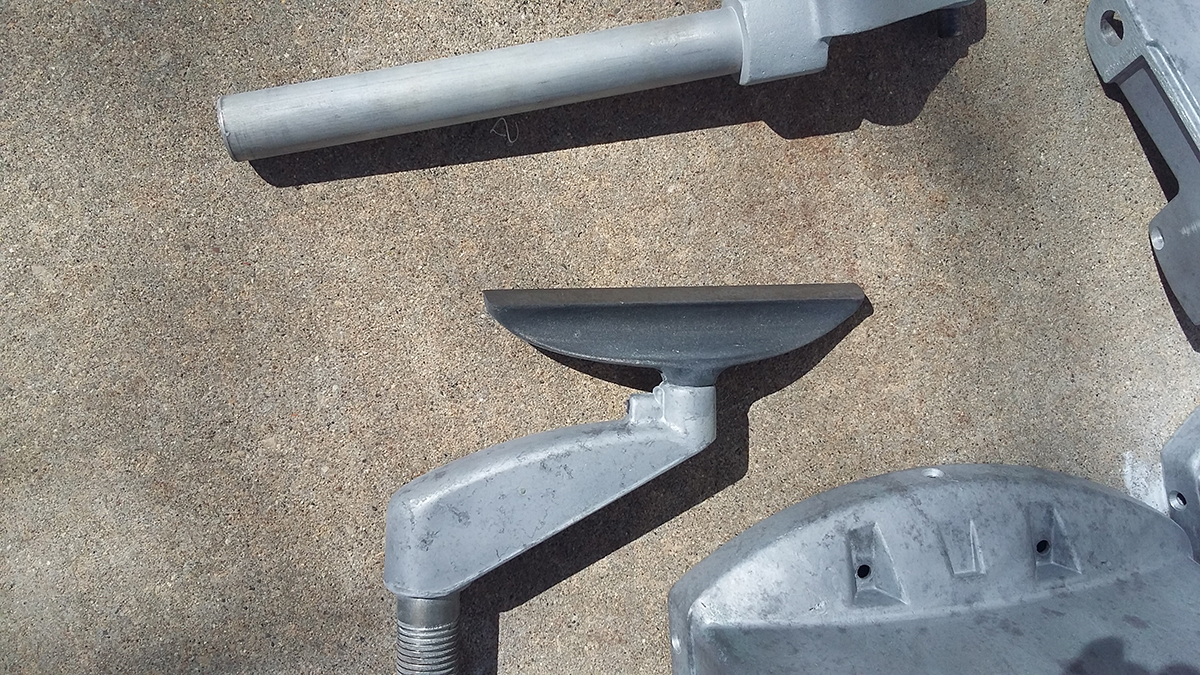

Here you can see the difference between aluminum and cast iron that has been soda blasted, the cast iron comes out looking like a raw casting, rather than a sand blasted part.
Lathe tool rest and arm.jpg (793.31 KiB) Viewed 3634 times
