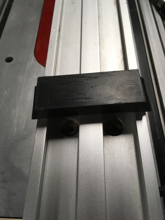

I don't often use the flexible scale.
However the few times I have I usually find the small black plastic piece missing because the adhesive failed :mad:

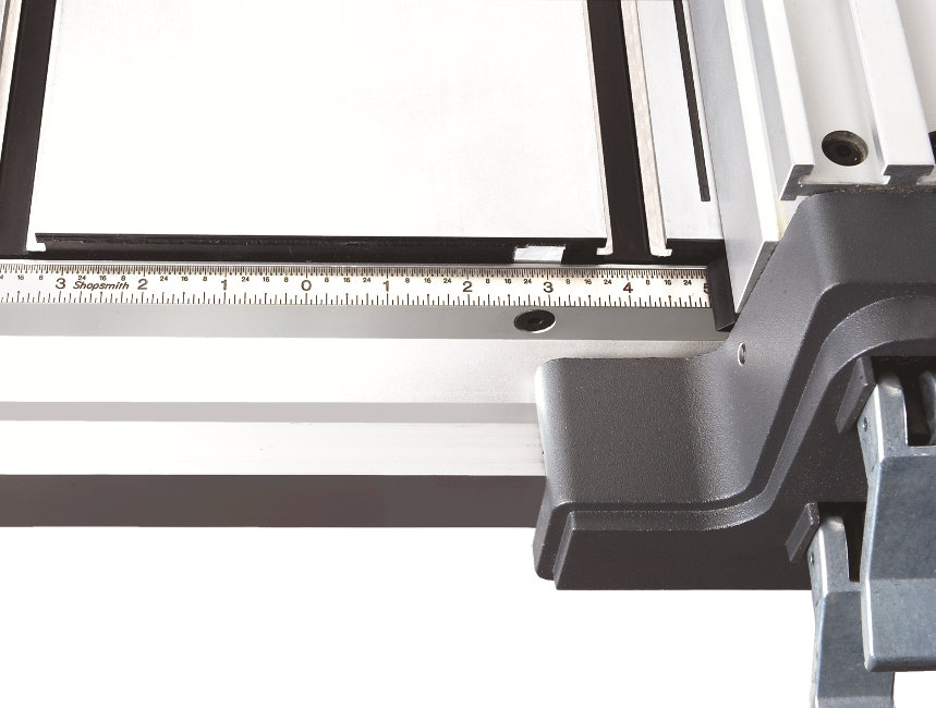

It is also a bit difficult for these eyes to see that little sliver of black under the fence well without extra light. Notice how well the SS photo is lit!!

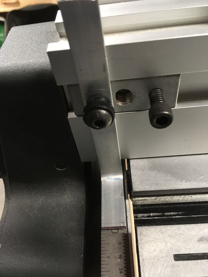

I decide to make my own -------
1 sliding T-nut
1 button head bolt
1 hex head cap screw
1 piece of aluminum about 5" by 1/8"

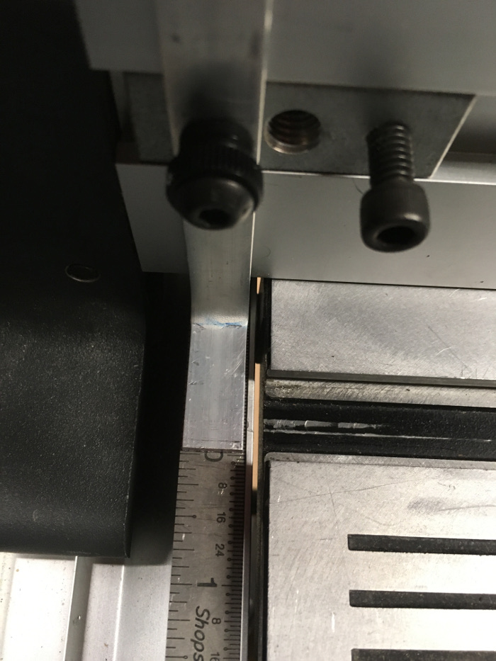

Took the aluminum to the vise and bent it as close to square and 90 degrees as I could by hand.
Drilled a hole about 2 1/2" up from the bend, just big enough for the 1/4 20 button head to go through.
The button head was too long so I found a spacer. The cap screw is used to keep the nut from moving.
I was going to taper the leading edge and paint it bright red, but the silver against the tape is enough of a contrast and the bottom edge is close enough I don't worry about a misread.
I can use it on either side of the fence, though I seldom have the fence on the left side of the blade. Easy to set up and easy to remove.
SS wants +6$ for that plastic piece. Not including the cost of a Sliding T-nut since it has multiple uses, I don't think I have $2 in materials, plus I don't have to worry about finding and reattaching the plastic piece every spring. :)

The small plastic piece (not pointer) Has also been a problem for me. About a year ago I had both fences without the small plastic piece. They had come off and had been stashed away in the parts drawer. I decided to reattach them and I used double side carpet tape. That fix seems to be working well.
However, one of the markers (the small plastic piece) has been damaged. I wanted to add it to my "To Be Ordered" list but I can not find a part number for it. It is not included in the parts explosion for the Pro Fence.
I guess I'll be making one (maybe two) for myself.
As for the steel tape being accidentally removed. That has been a continuous problem since day one. I put up with it because I use it a lot. I agree with Ed Reible that the steel tape is either too wide or the fence and the magnetic tape is too narrow. The steel tape hangs out over the edge about 1/16" (just enough to be snagged). I hater using kludges to "fix" things but I believe the front rail is going to "get kludged".
I'm thinking that a piece of carpet tape applied across the length of the front rail may buffer that over hang so that the steel tape is less susceptible to being snagged.
