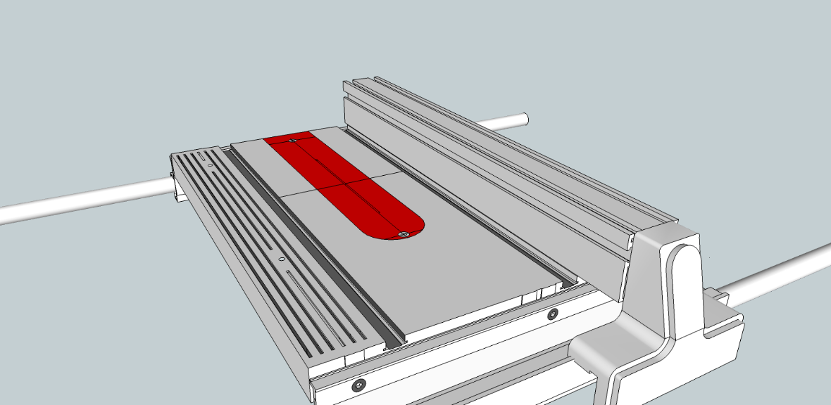

The answer to your question is the X axis.reubenjames wrote:X axis or Z axis?
The table does not facilitate alignment to center on the z axis. However, I do take note of table position in that axis. It is not important for saw operations. That axis does come into play when you go to the drill press mode.
On my table when aligned the way I want it, the drill meets the table 9" from the rear of the table. Table movement during alignment does not allow much deviation and what it does allow is of no consequence.
I have a separate table insert for use in drill press mode. It is 3/4" thick and has the center point marked because I have drilled into it.
