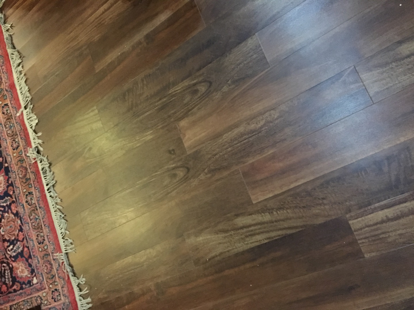

I have it my my basement. Many different brands and qualities. My wife picked this one out.
I like it a lot. The color is off because of the lighting.

algale wrote:I have it my my basement. Many different brands and qualities. My wife picked this one out. I like it a lot. The color is off because of the lighting.
Thanks Al, looks great! Is yours the glue-down or the lock-together type? Did you install it yourself?

Not glued down. Locked together. The pros did it.
About 10 years before this, I had installed an engineered hardwood floor that locked in place. It got destroyed when we had some burst pipes that flooded the basement. My wife didn't want that again so we went with the LVP. I was skeptical, but I really like it, in some ways more than the engineered hard wood.
The only negative I would give it is that objects left in one spot a long time will leave an impression in the flooring (chair feet, for example). So far, however, the vinyl has sprung back after a couple of days.
