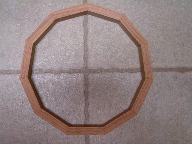

Don't know about the aluminum version, I got the wood one and it is very accurate. Got both the one for angles and segments. The first thing I made, just for fun, is an eleven segment circle. Haven't yet found a purpose for it yet. Maybe a clock someday.

Charlese has a previous post that shows an eleven segment circle and the cuts seem to come together seamlessly
That is somewhat difficult to do because the circle's diameter is not along a glue line of two segments. With an even number of segments the diameter of the circle will be along the glue line of two segments on opposite sides of the circle. The faces of those segments can be sanded to come together seamlessly to form a circle. Much more difficult with an odd number of segments!!! My hat is off to Charlese.
