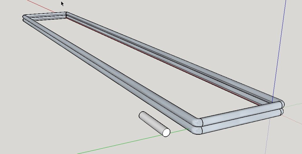

This is really early in the design phase but one idea is to use a frame like this made out of tubing. I've refined the dimensions somewhat, the inside will be some where in the 8" across by 56" long. Height now stands at 1-1/4" without the skin. Hinge is along one of the long sides.
It will hold rails.
ScreenHunter_170 May. 09 19.13.jpg (48.03 KiB) Viewed 5034 times
Again this is really early in the playing around with ideas phase. The finished design might not look at all like this.

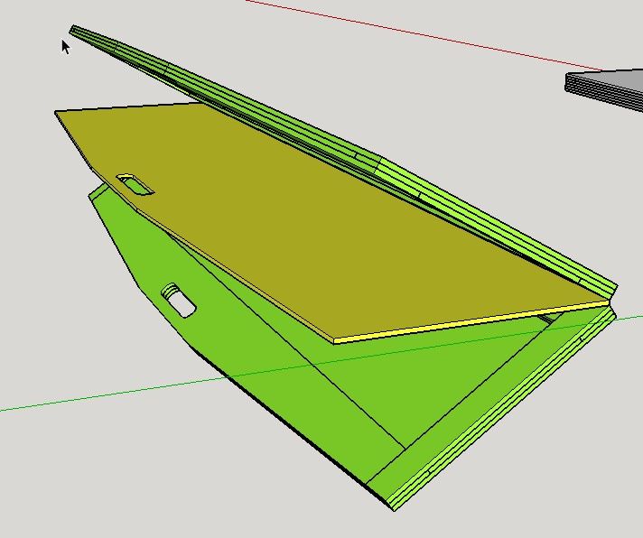

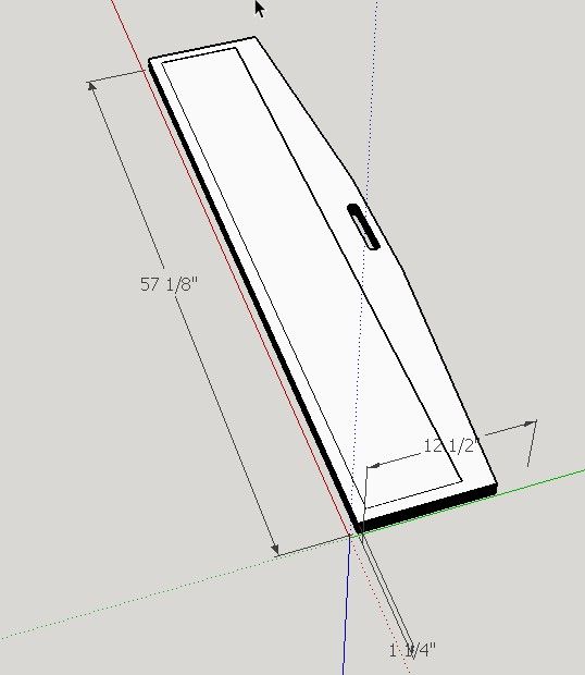

I've turned out two more designs, one with all 1/4 ply and the other with a mix of 1/4" and 1/8". These two are just plywood versions, the tube version I think I'll save for another project.
ScreenHunter_172 May. 10 21.18.jpg (45.37 KiB) Viewed 4874 times
ScreenHunter_171 May. 10 21.18.jpg (30.11 KiB) Viewed 4874 times
I have a couple more ideas I might draw up as well. Still getting rain so no way can I actually work on these so why not play in sketchup.
