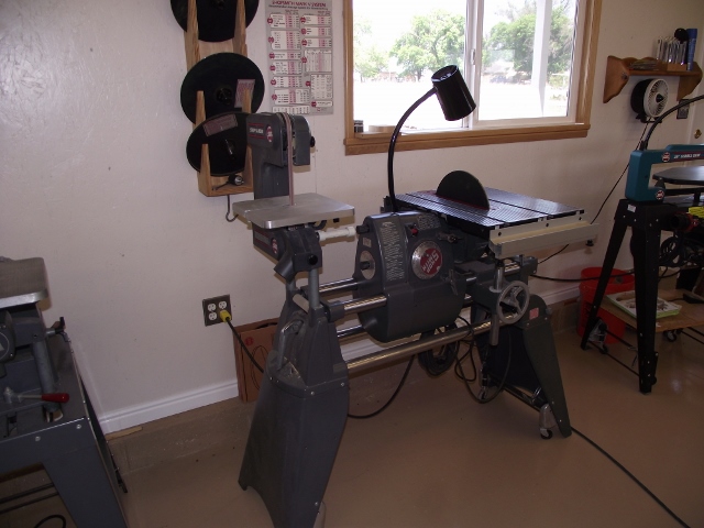

reible wrote:I've been thinking about making one as well. I have left over end castings from my dual tilt upgrade, a headstock just sitting on the floor and some extra bits left from my 500 to 520 upgrade so if I got some legs and casters and tubes I'd have it.
Not sure I really need it but.......
The hard part would be deciding on what functions I'd like to retain if any from it being a normal 500 or if I should even being thinking about doing this as I have plenty of machines already.
Looking forward to hearing what length you decide on and perhaps why?
I cut 16" off mine and some times wish I had cut 1" less off. As built, I can use all of the SPTs. My Shorty supports an in shop Belt Sander (Sanding Station) and Drill Press most of the time. However, whenever I need the 5in1 functionality somewhere other than at home, I load up the Shorty and go mobile.
I can't load the Shorty anymore so I have to solicit help. That usually comes from whoever needs the work done (one of the grand kids).

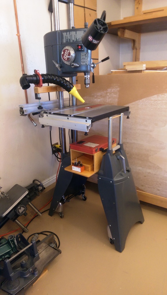

jjbuzard wrote:I intend on keeping all functions, except the lathe, ok maybe keep bowl turning capabilities, I saw one set up I liked on LumberJocks and like Bill said, it was 34" way tubes, so I plan on starting there, Thanks for confirming my thoughts Bill. Still in Missouri til Sunday night, then I can get home and back to my shop, lots of Soda Blasting of Aluminum parts and Black Beauty Blast of steel parts. Once the bench tube length is determined, they will be Powder Coated. And I intend to use the new Shopsmith Gray, I just wish I could get it in quarts so I could spray it with a spray gun, better results. I might have to experiment with mixing my own on that. Need to order 50 pounds of soda from Harbour Freight, hard to believe they ship it for $6.00.
I cut 18" off to make my shorty. It works fine and I use it mostly as a sanding station. I used the left over 18" pieces of bench tubes to make my dedicated drill press.
DSCF1168 (640x480).jpg (216.86 KiB) Viewed 28115 times
